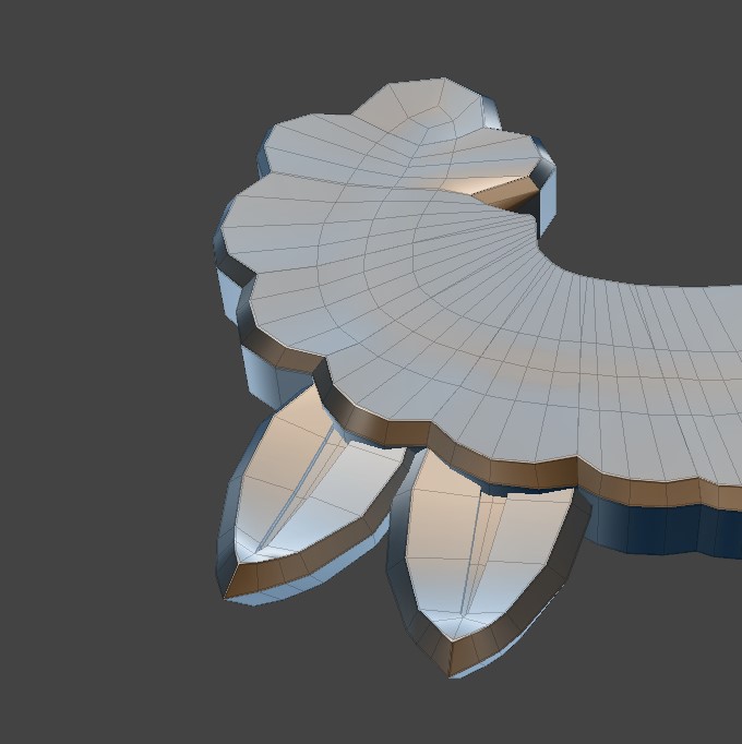

I like to build my subd meshes in Modo. I would like to have easy and EXACT conversion from subd polygonal meshes to NURBS which will have same functionality as native one (booleans, fillets, thickening). I don`t want to fully rebuild my designs. I would like to import it and use it in Rhino.
Unfortunately this will cause you more difficulty in the future. If you are producing files for machining, hard surface objects should be should be modeled from the start in a CAD application. Sculptural work is an exception, and requires additional consideration.

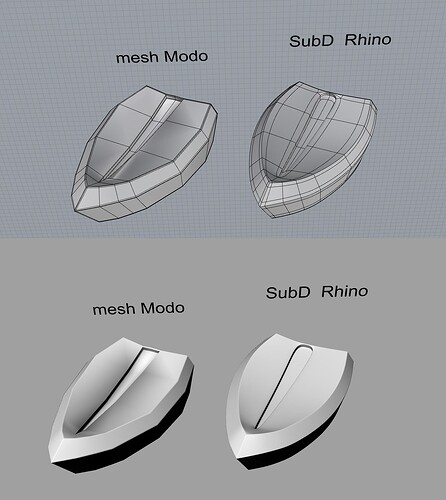

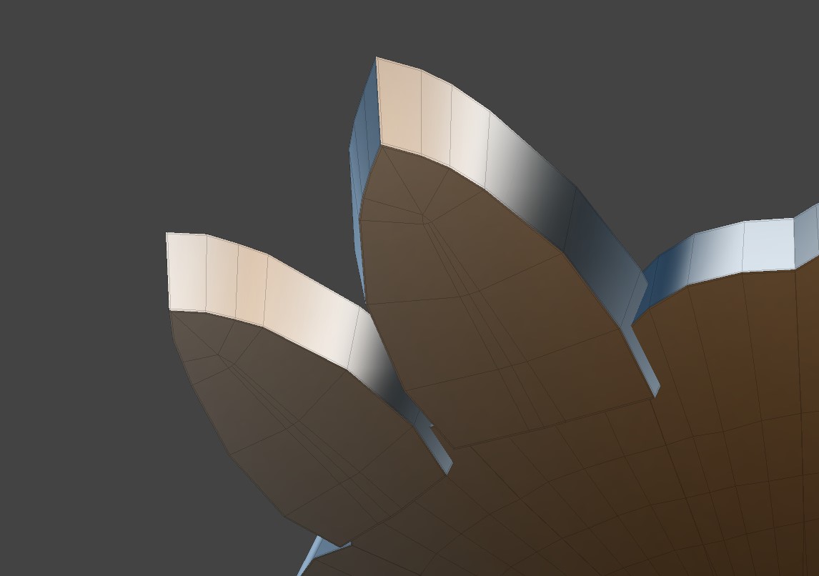

Thickening objects to a greater thickness than the minimum curvature radius will be a bigger problem with nurbs from subd. Because your rounded corners are baked in, if you run into thickening problems you won’t have any options, unless you can recreate the subd with a hard edge in those areas.
All your rounded corners should be hard edges that you can more easily change the fillet later as needed.
So what is best workflow to rebuild meshes like this? I will delete all additional edges to left hard edges only and what next? Any tutorial for best manual conversion from subd to nurbs?

Thickening: terrible on sharp creases and in any situations where the offset amount creates self-intersections of ‘bow-ties’, also very inaccurate since it currently offsets based on the normals of each control point, not The normal of the low-poly surfaces that those points define. You are better off converting to Nurbs first, and they doing _OffsetSrf and _Shell to the nurbs. But in either case there will be manual labor to solve tricky areas.

That uploaded meshes and those filleting and shelling was only example. I may do shelling and filleting in Modo and export all subd meshes. Then I would need only booleans (addition, substraction, intersection). So in other way I may import whole complex model builded from many parts as many subd models. It may contains baked fillets and shelling as external substraction booleans model to carve it in Rhino. That post here and in MoI3d forum is my research in that area

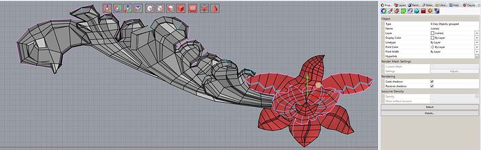

Hi, amazing model…
I expect you needed more then a day to finish this.

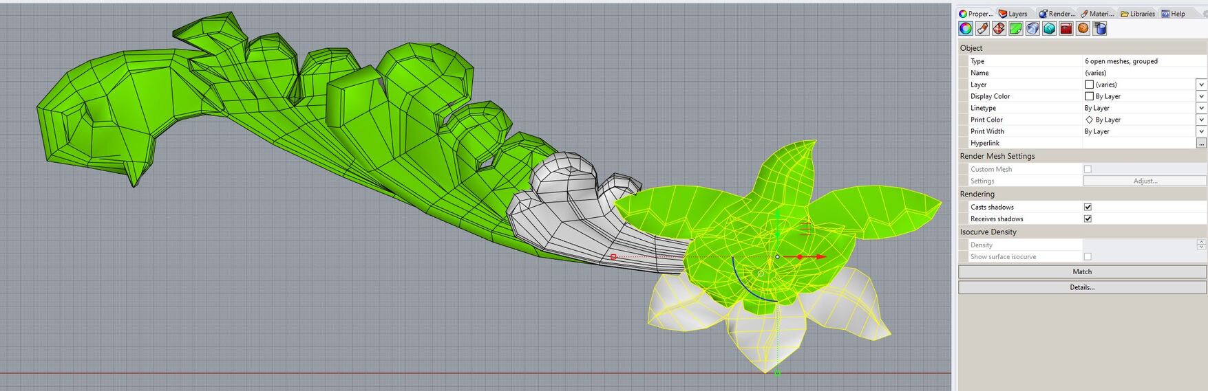

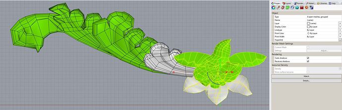

I it possible save your Clayoo object as is and then continue working on it later?
As soon as I close Rhino it coverts it to a Mesh object. One workaround is to change to Cage view mode before closing Rhino as is later fairly simple to continue but still, there is always need to fix converted mesh as it adds edges to deal more complex geometry.
ClayoObject to SubD, the file is 8 times smaller in size than it was, and the quality of the part is not lost, and faster can be edited in Rhino under SubD.
