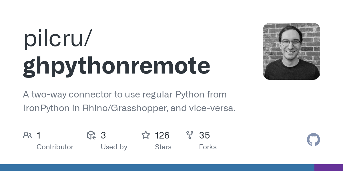

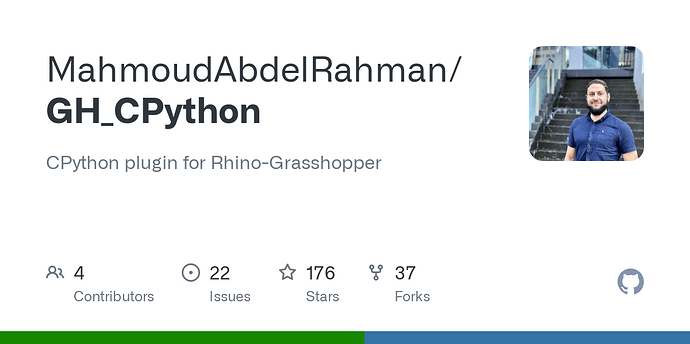

I’d suggest trying the same if installing comtypes fails, since it is already working in your external CPython interpreter. There are these two options currently (that I know of):
