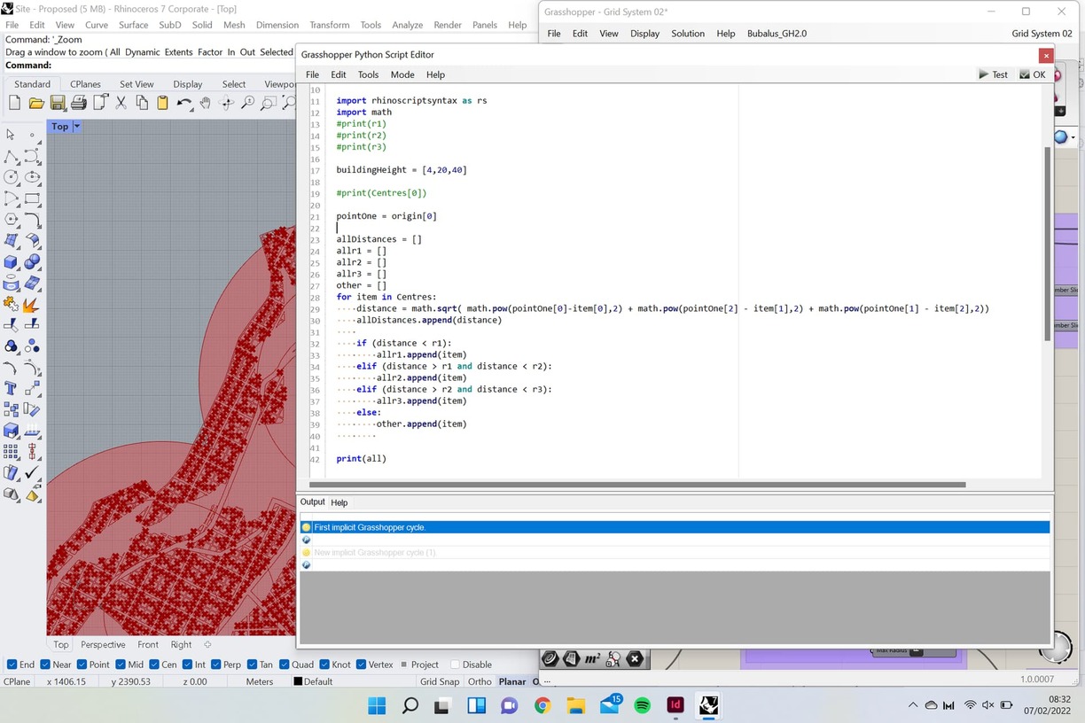

Hi all,
Trying to create density zones with buildings heights higher in the centre (40 to 60m) and lower (20 to 39m) as you go out using Python in Grasshopper. I have managed to set the two origin points and distance rules to filter the areas. (eg. distance from p^n < r^1 = inside that zone p^n > r^1 < r^2 = inside that zone where p means point and r means radius). If anyone can share some python knowledge on what my next steps should be, please do get in touch! Screenshot of my script is attached!
