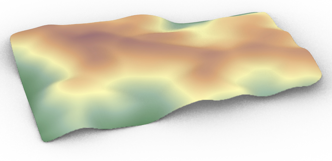

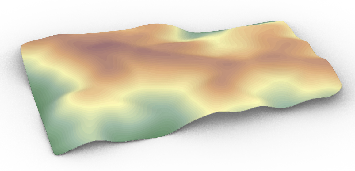

Small update for those interested:
Here’s what I’m wokring on:
A “shader” that generates a 5 color gradient to illustrate altitude on terrains.
The 5 colors are customizable and so are the “steps” in the colors. I want those so it easy to follow a contour.
Here you can see the same gradient with out steps:

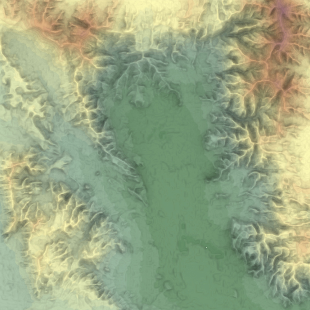

And shown from top on a peaky landscape:

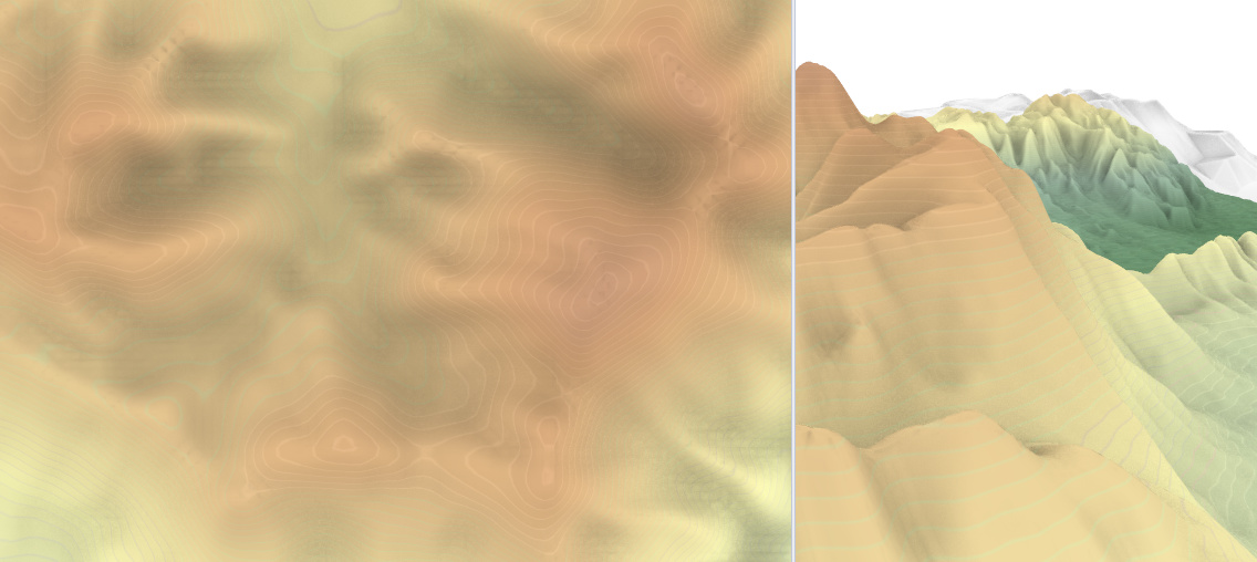

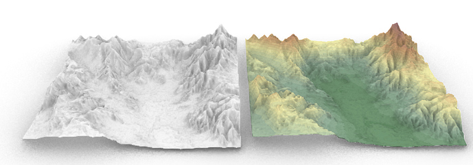

And a with/without comparison:
Now I just need to iron out a few material generating issues, but it serves my purpose so I can live with a few hickups for a while :slight_smile:

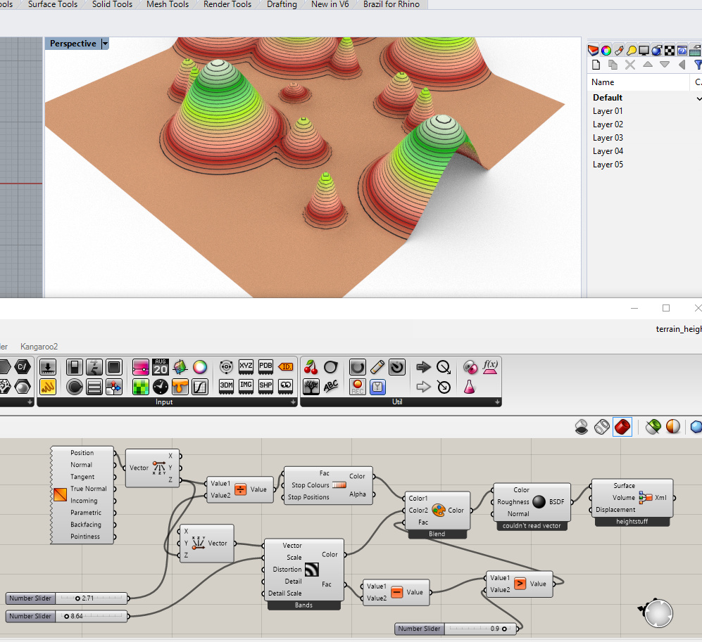

With Raytraced you could make a custom material and have a color ramp driven by that height (:
For fun
terrain_height.3dm (655.7 KB)
terrain_height.gh (15.0 KB)

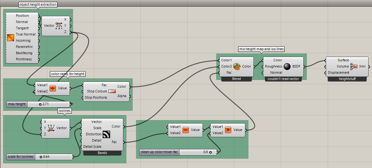

here a slightly cleaned up GH with some groupings and namings. Maybe a bit easier to understand: terrain_height.gh (15.7 KB)
I love it, here I work my butt off at night time and you just cook an interactive tool together for fun… :smiley: Thanks for sharing, I’ll dig into it and see what I can learn. And come over to Norway for a weekend, I have some beers here with your name on it!
