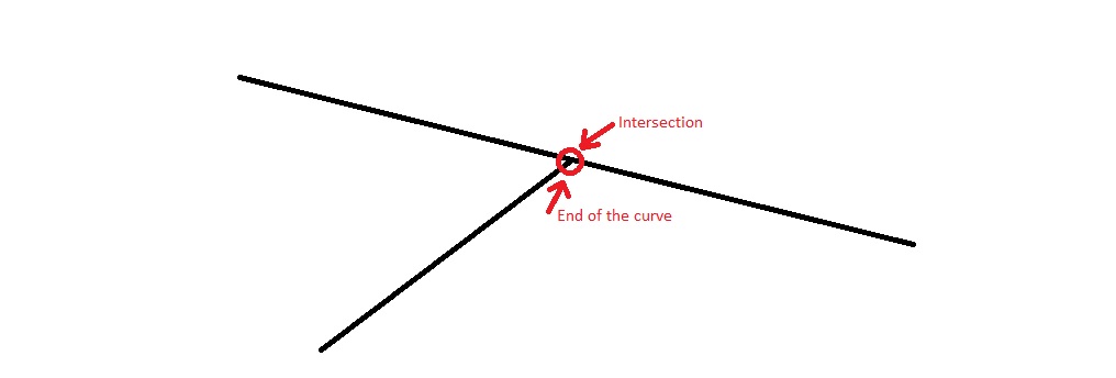

I am having an issue that I did not realize before that Rhino has a point tolerance. It concluded that points;
-5.26930645920454,6.6957560903893,0 and
-5.26930645920482,6.6957560903894,0
are not the same. The first coordinate came from a CurveCurveIntersection and the second came from the end point of the curve. Basically I try to compare the end of the curve (that made the instersection with the curve) and the intersection. Is it possible that I got this result?

Therefore: comparing two points are exactly the same (==) will almost never work. You should check if the distance between these two points is less than the document tolerance to conclude if they are the same point.
Not sure about python, but in C# it would be
bool isSamePoint = ptA.DistanceTo(ptB) < RhinoDoc.ActiveDoc.ModelAbsoluteTolerance

In most cases, the equality test above should be written as something like the following:
double tolerance = ...
if (System.Math.Abs(x - y) < tolerance)
Here tolerance is some threshold that defines what is “close enough” for equality. This begs the question of how close is close enough. This cannot be answered in the abstract; you have to know something about your particular problem to know how close is close enough in your context.
