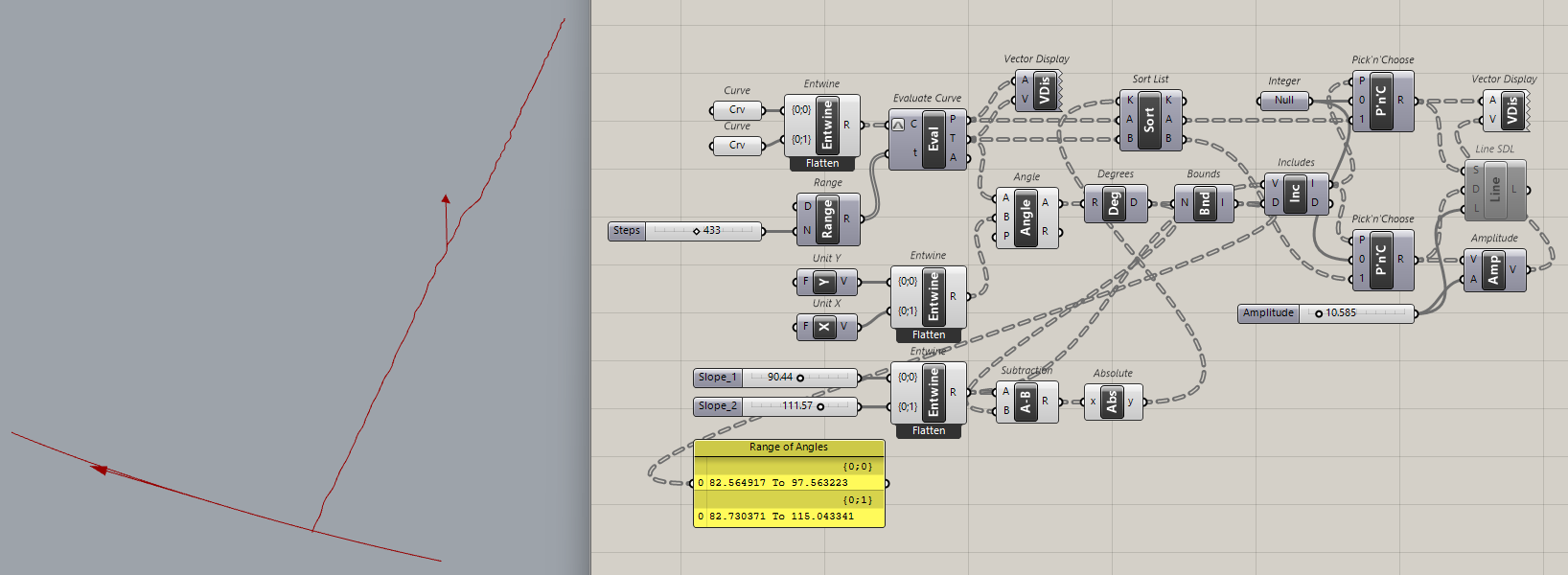

This version works on two curves at once. ‘Slope_1’ slider sets the target slope on the smooth curve at the bottom, ‘Slope_2’ slider sets the target slope on the wiggly curve (which has multiple points that match the target slope, even though I show only one).
Slope angles are measured relative to X and Y directions respectively and use absolute value, but all of that could be changed.
curve slope_2025Apr28a.gh (58.6 KB)
The difficult part of this code was showing nothing when the range of angles is exceeded.

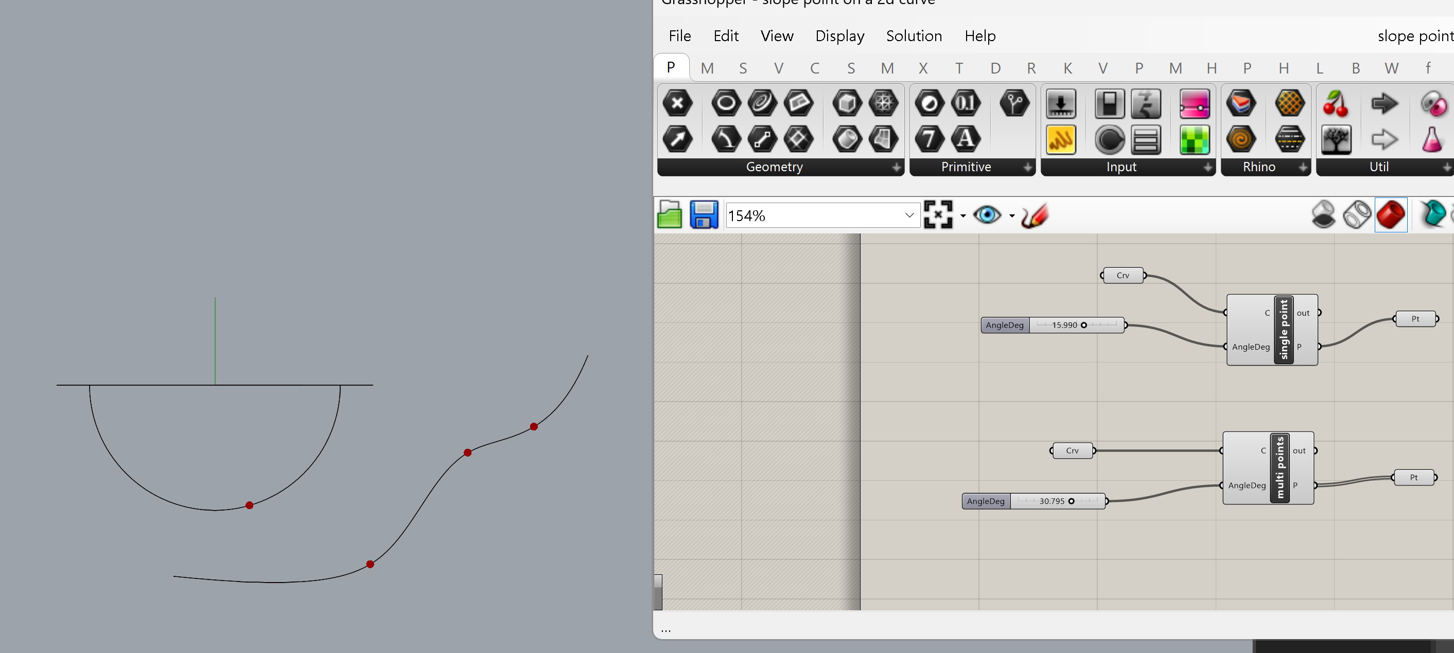

I had my new best friend chatGPT knock up a vb control, so its not my work but it seems to work on a 2d curve
Phil
slope point on a 2d curve.gh (11.5 KB)
point at a slope.3dm (38.8 KB)

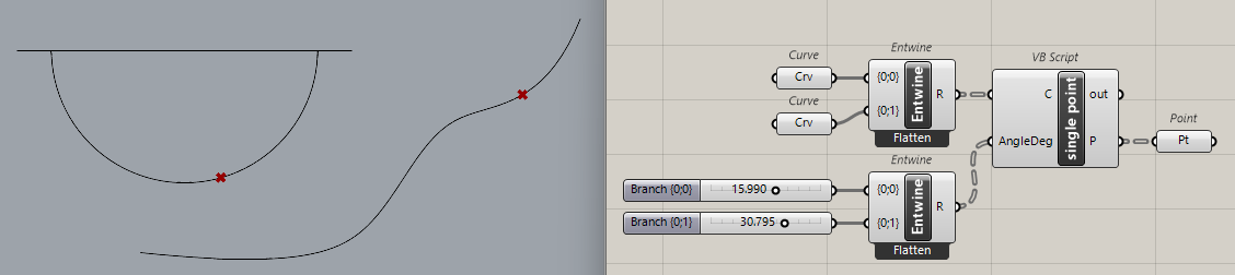

It sort of works using multiple curves but showing multiple points stops working:
slope point on a 2d curve_JO.gh (6.8 KB)

in this case a horizontal line is 0 deg
rotate 45 deg ccw and that is 45 deg.
it is only a show and tell as i am novice at this stuff.i only use it to get past momentary hurdles,

Both solutions (spaghetis script from Joesph, and VB from Philip’s best friend) work in a discrete approach by testing x points along the curve if I am correct ?
I’ve seen worse spaghetti GH. My name is spelled like “Jose” with “ph” added.
