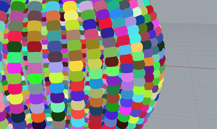

Hi, yeah, something went wrong with the upload… I try again.

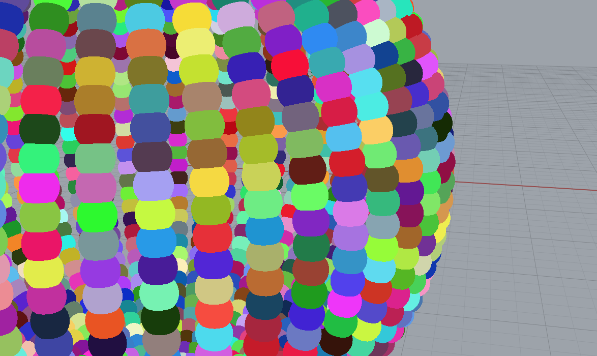

Here you can compare round with squares, and see that the round dots “suffer” in the coverage due to the lacking corners. (Thus a slight upscale with 1.13 would give the same area as the rectangles):
I also see here that the round points are actually a bit faster than square. (2.80 vs 2.86 sec for 100 redraws, so that was quite impressive)

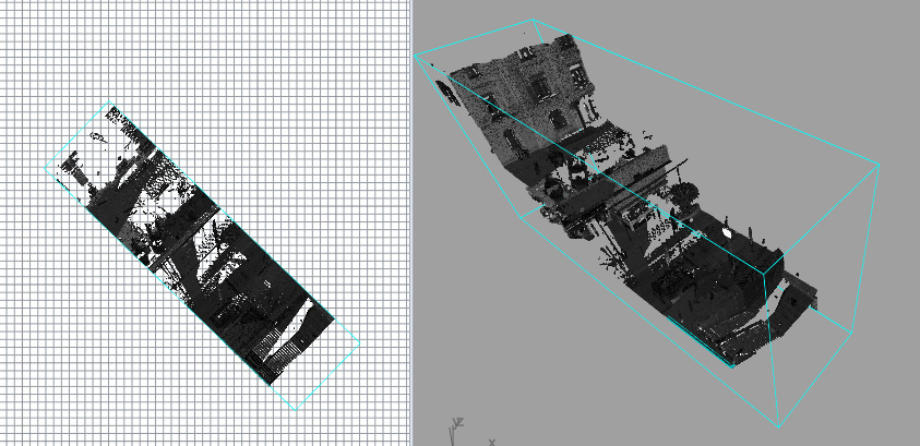

And we need a clippingbox… Here is my customscript in action:
Sure, but that is always going to happen no matter what the scale. I really don’t like the idea of upscaling for area when the input setting is supposed to be a real world diameter. I can’t imagine you would toggle back and forth between square and circle in practice, so just setting a diameter of 1.13 in the settings for a circle would give you the same behavior.
I would call that a negligible difference and may be due the a few pixels on the edges of the circles being discarded.

Size: I was just looking at it from a visual perspective, and agree with you that the unit size should control the size.
Speed: I was really surprised that round dots were not slower than squares, so I just wanted you to know even thought the difference is minimal (but it was consistent)

Clippingbox: Absolutely OT regarding the underlying code, but related to real life use quite like “picking” above. It is just meant as feedback for the big picture and down the road development :slight_smile:

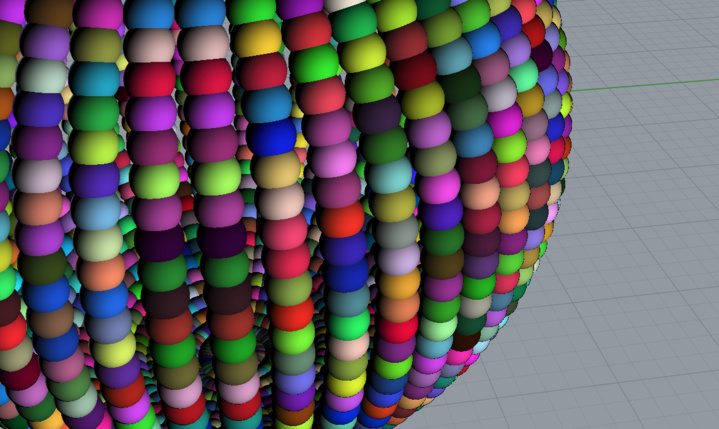

The next build will include “Box” and “Sphere” style display in the TestPointCloudStyle command. The lighting calculations are a bit messed up at the moment, but Jeff is going to help me track down and fix this. @DavidRutten I think this is what you have been requesting for a while in https://mcneel.myjetbrains.com/youtrack/issue/RH-36001
Yeah this is great. However for diagramming one doesn’t necessarily wish to have lighting and shading. For those cases sphere-like depth with plain flat shading would be needed.
No problem, I’ll add unlit versions for both boxes and spheres. That is very easy to add.
Done; creating a pull request for this now
Smooth! The capture does not do it justice.
