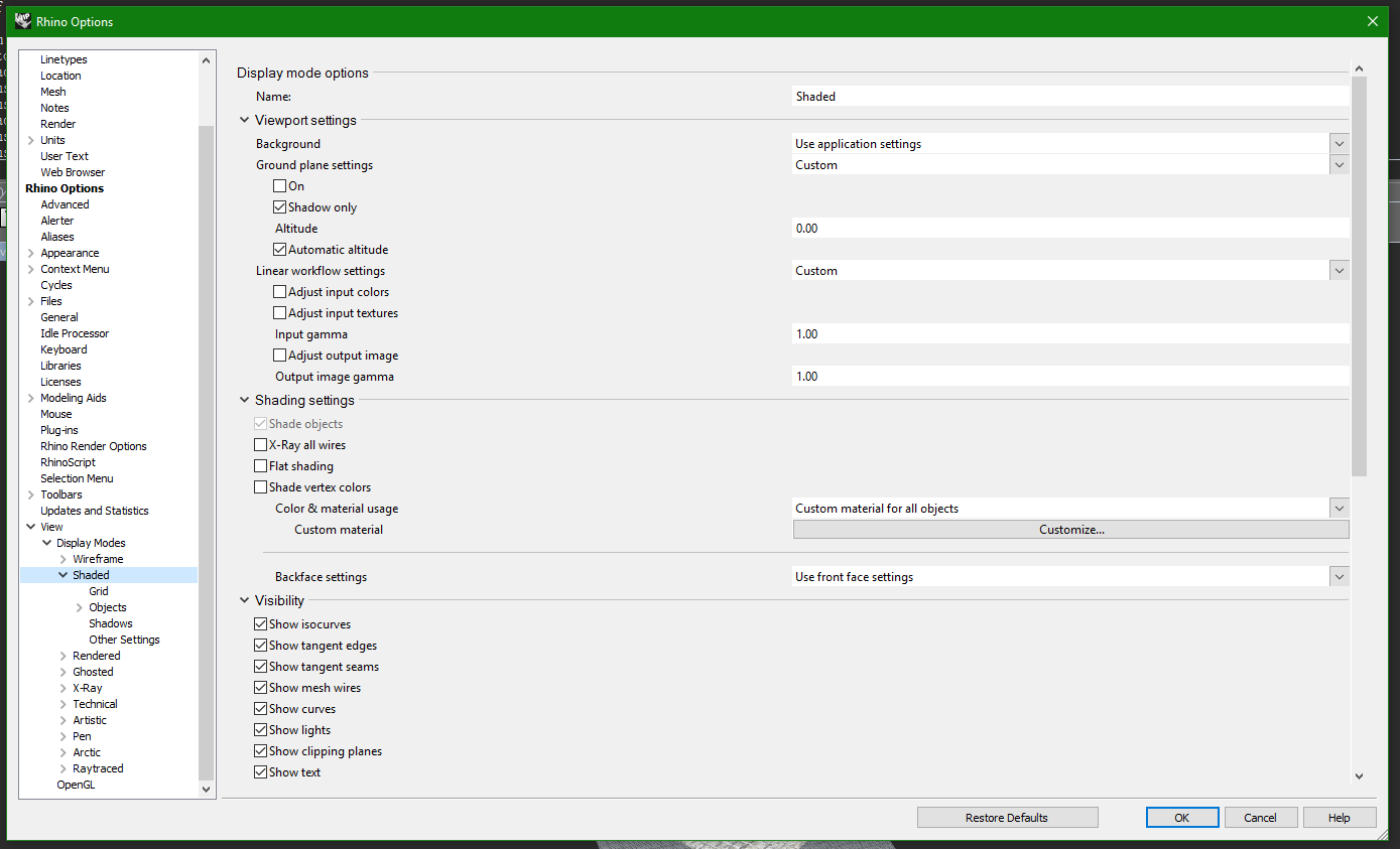

Hi Colby - can you check that all the display modes are set to defaults? (Options > View > Display Modes, poke restore defaults on at least the mode that is currently showing the problem… Any different?

I set the ‘shaded’ display mode to default settings; Never having changed them before. Made sure that the display mode is ‘shaded,’ then selected the point cloud, and have shown the object properties. Let me know if you would like to see a point cloud with fewer or more points.
