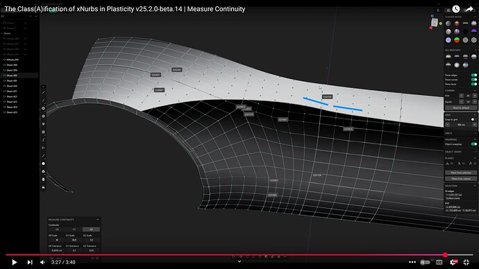

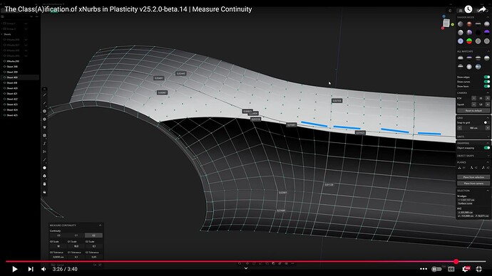

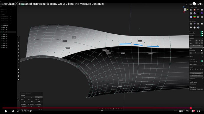

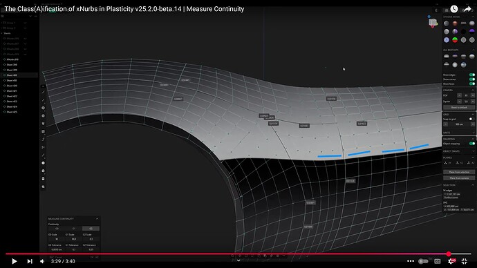

Also, having single-span surfaces with G2 matching does not mean a model is Class-A quality. The latter is strictly related to the perfect visual smoothness, whereas the video you posted above shows a random model with lots of imperfections and waviness. :smiley:
A clear example for this is the moment after 4:44 minute in the following video. The surfaces may have close to G2 continuity, but the surface patch layout is completely wrong and the waviness across all 3 newly built surfaces is super obvious. What they lack is a visual surface smoothness.
Opening this model in Rhino will reveal all the imperfections thanks to the advanced analysis tools. It’s a nice model for visual purposes, but far from Class-A. Don’t get offended just because I can prove the truth.
This is not “near G2”, these are G2 transitions as you can see from the curvature deviation analysis on screen. And if you don’t like the reflection pull the CVs until you like them? This is how you do it in any software including Rhino. This solely depends on the user, not the software. I agree that this is not an ideal setup of surfaces in the video you posted, too fragmented, wrong hierarchy, this is probably not how a professional would build this chassis. But this is user error and not the fault of the software, is it?
See, I totally agree that Plasticity isn’t there yet. Especially without curvature combs it’s basically impossible to do this kind of surfacing on a serious level because relying on zebras and mathematical curvature analysis can only get you so far. I wouldn’t recommend plasticity (yet) to anyone who wants to build cars. For that matter probably many pros would vehemently disagree that Rhino is the right tool either, but everybody should use what they like :slight_smile:
But what I’m seeing is just that they have added more surfacing features in the last half year than Rhino did in the last ten. Their align/match tool is out for a couple of weeks and it already can do things that Rhino still can’t do (CV blending). I think hand waving this away because some guy on youtube didn’t build the perfect reflections in ten minutes is a dangerous approach. I’m not saying we all have to switch to plasticity, it’s more about asking McNeel why we can’t have these things?
And what advanced analysis tools in Rhino do you specifically mean? Can you name the commands? I’d like to put them on plasticity’s public feature request board, they have a habit of implementing this stuff very quickly. Maybe this pain point of yours could be removed quickly. Curvature combs is an obvious one, but what else?
