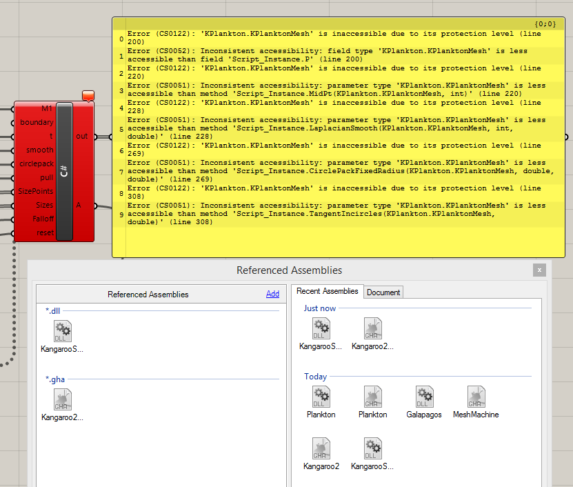

I’m having trouble getting this installed/functioning. I am running Rhino V6 and Kangaroo2. I’ve downloaded plankton.dll, plankton.gha, and MeshMachine.gha. I moved them all to Program Files/Rhino 6/Plugin-ins/Grasshopper/Components. I’ve also copied them to the AppData/Roaming/Grasshopper/Libraries folder to see if that helped. They are all unblocked.
When I open Grasshopper I can place Plankton components on the canvas, but when I open Daniel’s Remesh_Plankton_circles.gh, I am presented with a series of popups to resolve assembly references:
When it asks for a “New” KangarooLib.dll do I choose KangarooSolver.dll?
When it asks for a “New” PlanktonGH.dll do I choose Plankton.dll?
When it asks for a “New” GH_Kangaroo.dll do I choose Kangaroo2Component.gha?
If I do specify files as described above, I still get errors:
VertexNeighbours, NakedVertices, Combine & Clean (all Kangaroo functions) are not installed

Hi Daniel - thank you so much for your prompt response! I am working on my home machine to get this ready for monday, but I’m still having trouble. Do I still need to add meshmachine.gha to the C# assemblies? Below is there error message I get after pointing to the dll’s/gha’s in the Components folder.
Any idea what’s got it hung up?
**edit - I noticed i have Kangaroo and Kangaroo2 in my ribbon, but the only thing in the Kangaroo tab is MeshMachine.

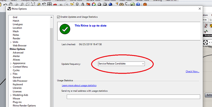

Ah sorry, I should have specified - this will need you to be running the very latest R6 service release candidate.
Then the only referenced assemblies you should set for the script are KangarooSolver.dll and Kangaroo2Component.gha
I’m running V6 SR15, which seems to be the latest. I’ve downloaded the Kangaroo dll & gha again just to be sure they’re not old, but I’m still getting the errors. I’m wondering if I’m doing something obvious (I’m not all that great with Kangaroo…). I toggle the reset boolean a few time, I’ve unblocked the timer in the Windows tray.

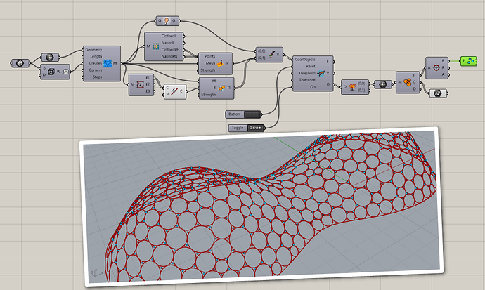

I’ll fix the remeshing script to include the boundary tangency at some point, but here’s another way of doing it with already inbuilt Kangaroo components (which do now include something for circle packing meshes tangent to a boundary curve). This separates the remeshing from the relaxation, but that often isn’t a problem. simplepave.gh (37.9 KB)

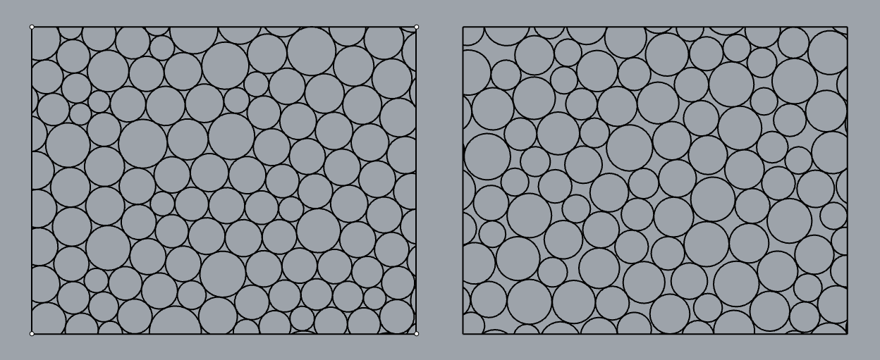

One thing about compact circle packings like this is that their radii are not independent - in fact once the points along the boundary are fixed, the combination of edge lengths is uniquely determined for a fixed mesh topology.
You could easily add a clampLength goal to the edges, but I suspect it won’t work well unless integrated into the remeshing step. I can have a look at adding this at some point.
There will still be a limit on how tight the ratio of smallest to largest circle can be though. I think it works out to around 3:5 because of how the remeshing works.
(talking here about compact packings - ie where all the gaps between circles are 3 sided. If you accept gaps with more sides, things are more flexible - you can even make the circles all the same size, though personally I don’t find these non compact packings as aesthetically pleasing)
As for sharp edges/corners - You can add creases to the remeshing, but what should happen to the circle packing across these creases?
If the circles just need to come tangent to the crease, it is probably easiest to just split the mesh at the creases and solve each patch independently
To illustrate - the one on the left is a true compact circle packing, and the one on the right is only a packing in the looser sense that each circle touches some of its neighbours
