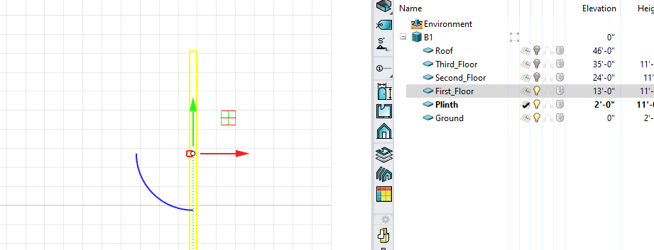

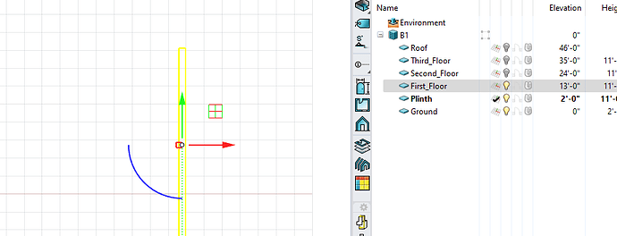

Hi, I am learning to make my own furniture template in VA 3 and I came across on an issue.
I just made a small slender solid and saved it to rhino model. Now I brought this same model into furniture style by creating new furniture style. I placed it on level 1 but its not visible in plan view unless top plan views are switched on. I also checked the cutting plane and its fine.Is it a bug? I am sharing my rhino model with the test file.
test.3dm (4.0 MB)
Hi @asisintel just uncheck the 3D block assigned to the plan view representation of that furniture style, and the object will be visible in plan views.
Actually, only 2D blocks should be allowed for plan view representation of object styles created from blocks.
