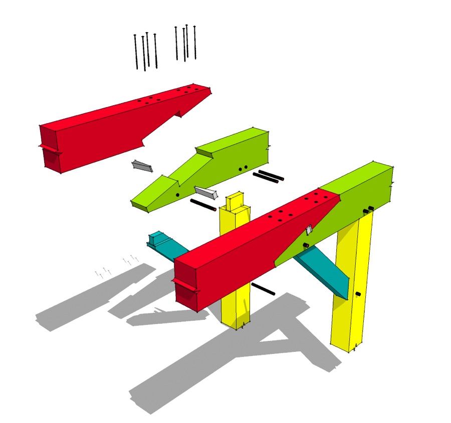

Parametric Japanese Timber Joinery for post and beam construction
It’s programmed from solids. The general process would be:
  1. Create solid geometry in Rhino.
  2. Use CAM software (maybe powermill?, but it’s very expensive) to generate machining paths
  3. Use machining paths with RoboDK to control actual robot
Possibly, later on, have an aditional step with the robot and doing automated photogrammetry of the work piece, but yeah that’s a year or two away…
Thanks for the the links. I’ve seen the GIFs before, but not the TimberframeHQ site. :+1:
You are correct, but there are an almost infinite amount of joints possible, best to just to attempt to deal with members meeting at 90deg to start with and go from there.
Here’s a version with internalised geometry.
2019 Parametric Joinery Dev01.gh (13.7 KB)

Just a heads up: the angle in the middle is too acute to be cut with a CNC router unless you either do a finish pass with a V-bit, set at an angle or you fillet the inside corner.
