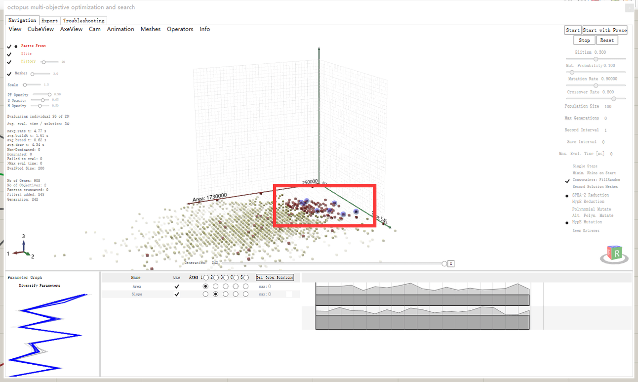

Hi Robert,
I have read your thesis and definitely push my understanding of MOEA into a deeper level.
However I see your paper used the old version of OCTOPUS and hence the instruction of it cannot
match the current version. cuz` you have lots of new function and development.
i.e. we can mark Pareto-front solutions with blue(preferred obj), and from the simulation it could tell the simulation direction or trend tends to be directed by these blue marks. So I guess now we can check the simulation time by time and subjectively lead the simulation direction?
It will be really brilliant if you could post a new MANUAL of current OCTOPUS USER GUIDE.
And I was wondering if you could share your e-mail so I could send my practices back to you as some samples of GA?
My email:lyang@coa-lab.com
Best wishes.
Lei
