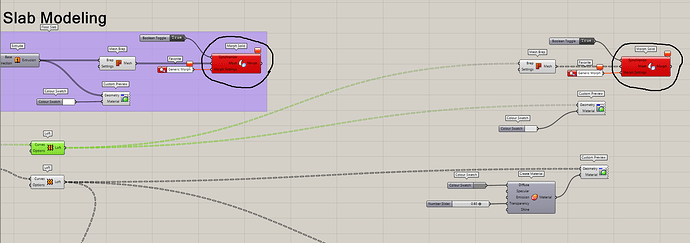

Pls, can I ask one more question?
I need to add the ArchiCad component to the script so that I can connect with Graphisoft ArchiCAD and continue with the remaining necessary things.
But the issue I’m having now is I’m unable to attach the ArchiCad slab component to it, the only component that I can attach is the Morph Solid and it works with it. But I need to connect it to the proper component, like the ArchiCad slab component to the Floor slab Modeling not Morph Solid and the wall component to the Elevator Modeling not Morph Solid. Those components I circle are the component I want to replace with the proper component.
Pls help me with this one too so that I can know to connect my Rhino+Grasshopper design with the Graphisoft ArchiCAD connection, I really need this if it is going to be the last, Thanks.
Sorry this is the file below
Skeleton - Hangzhou Wangchao Center - Grasshopper & Python tutorial.gh (39.8 KB)
I don’t use ArchiCad or this plug-in so I can’t help with this.
