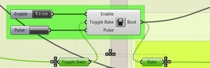

This may sound weird, but as a matter of fact, when I test local logical networks, sub networks which I often “chain-activate” by boolean triggers from other (earlier) stages of calculations, I often want to be able to trigger locally during development & testing of the sub network. For such situations I apply a std layout which I use frequently copying and dropping here and there in the logical network), like so:
Fig.3. Use Case : Picture shows a typical case, where I’m here is breaking up a “Bake signal” by inserting a component group used for Enable/Disable the “bool channel” altogether - while keeping the original signal attached. While at the same time providing myself with a loop-hole to locally trigger the signal (the “Pulse” button) for testing purposes.
Notice the double functionality; #1: Enable/Disable the signal altogether, and #2: while the original signal is available but not currently sending its signal, I can still trigger locally a (bool) pulse by pressing the Button component.

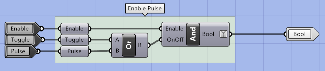

Fig.4. This component consists of the following logic :
So why don’t I just use what I already have? Well I do use it, all the time, but the buttons are not included in a “cluster” component, and thus will not be dropped on the canvas together with the logic. And, dragging this thing around suffers from the problem related to position locking of the components - the whole group is easily messed up when dragging it around in order to have it “within reach” from the trouble-spot being tested.
So: A component to be desired is on which, when you drop it on the canvas, includes the buttons as well as the logic AND keeping the component group together as a whole when moving it around. It should have a regular Group area as a bottom plate as well, since that allows for different colors (for example making the group area glaringly red as to hint about local “tweaks” to be removed from the model when its tested and done). The buttons & the component should be position-locked to the local inner area of the group-area (see Wish #3 above) while allowing the area itself (the whole) being freely moved around.
