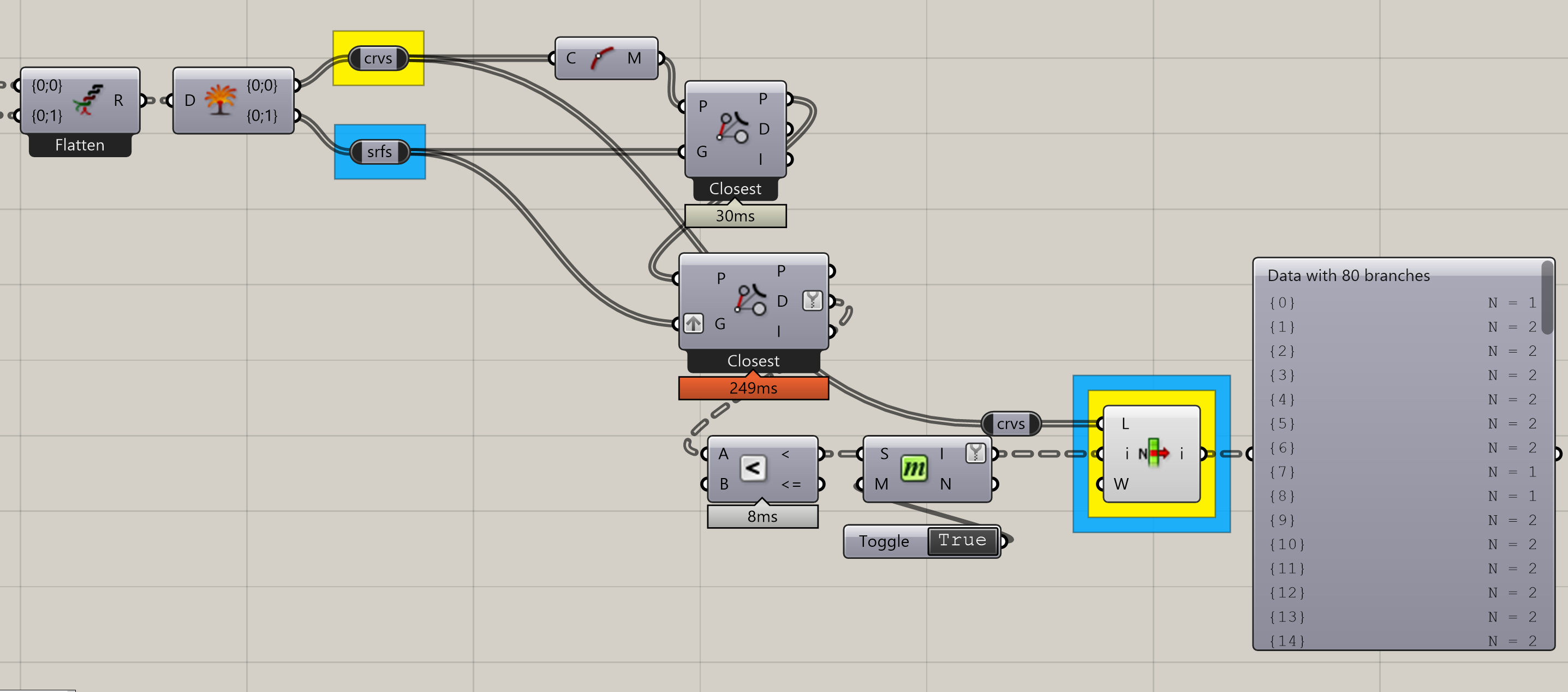

How to match every branch in blue group like the structure in yellow group. thanks
Mtrees.gh (60.6 KB)

Can you elaborate what you mean by ‘matching with surfaces’? Match curves to the surfaces they’re on or…?

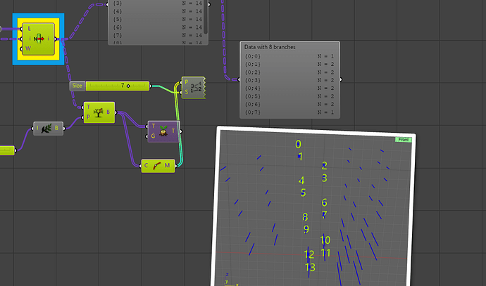

@CGHEEN Is this related to what you’re after?
Mtrees_b.gh (77.7 KB)
or this:
Mtrees_c.gh (77.7 KB)

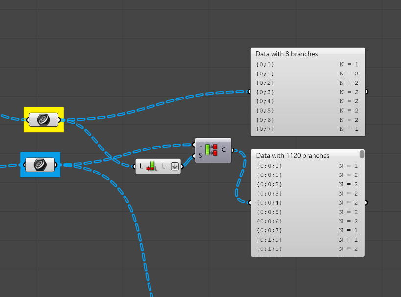

oh yes is about the same project. the series of surfaces who the first bunch is my first branch but what I want to achieve is that all the branches have the same order correspondig to surface suface 1 is closest to 1 line, second with 2 lines - 0;0 = 1 , 0;1 =2 … like the first param viewer or that partion list result but evaluating with the surfaces and not get a fisrt list to evaluate the lengh of the list and create a sub set wich is an option.
in fact maybe I just have to unflatten the branches ? which would be the guide ? lol Im lost
