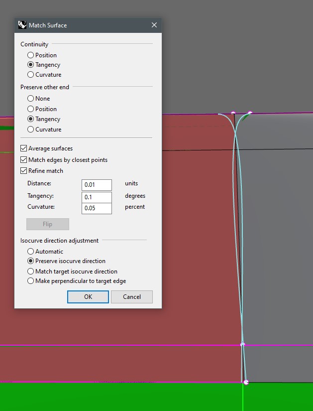

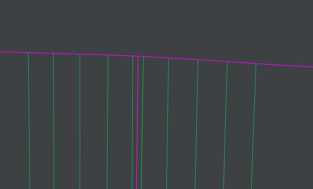

Hello! A bit late on this conversation… I have the same problem with rhino 7 SR15. It basically doesn’t modify/move the other surface when I match with “average surfaces” on. The surfaces edges are untrimmed and I already tried RebuildEdges but nothing changed. It worked on rhino 5
Hello- please post an example file and the settings used in MatchSrf.

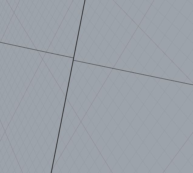

Hello Pascal, here is the .3dm file and 3 pictures: first one is with settings, second is after MatchSrf (see the overlap), the last one is how it should look (I just mirrored the surface)
Please tell me if it’s all clear or if you need more

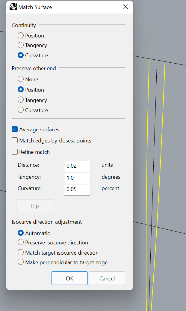

I just wanted to use it again. It literally never works for me (and I just updated Rhino as well). Again, the preview shows the expected result, but when you hit OK only one surface changes.
match-average.3dm (163.9 KB)
I am able to repeat this by using the _MultipleMatches option even though only one set of edges are matched. The GIF in the original message also shows _MultipleMatches being used.
[quote=“spb, post:17, topic:92281, full:true”]
[/quote] Good catch.
@pascal It appears that there is a bug when MultipleMatches is enabled and then Average surfaces is selected. Apparently the match is calculated based on averaging the surfaces, but then only the changes to the first surface are saved.
