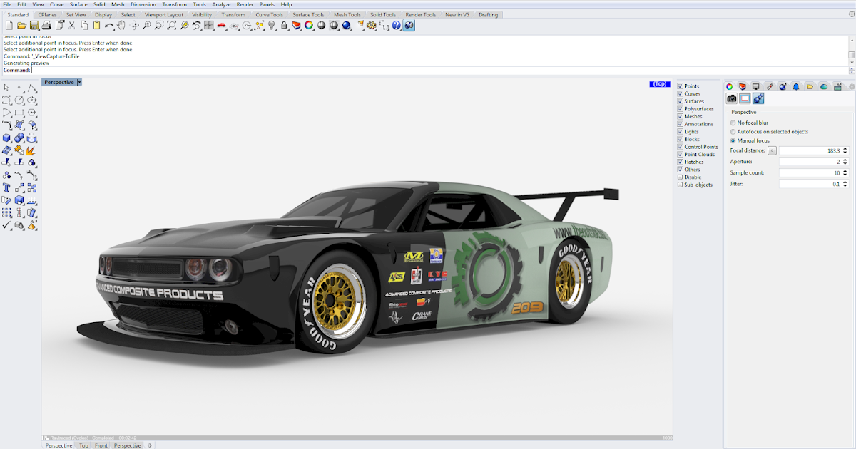

nope. Just trying to save to a folder on my hard drive located within the Documents folder. I’ve saved files there before but not using doPDF or ViewCaptureToFile.
Many thanks for the details, Scott. Clearly I need to spend some time learning more about the Render and Raytraced views. I need to see if I can find some tutorials on those views.
Here are more details on the Rhino 6 realtime stuff: https://www.rhino3d.com/6/new/presentation
Here is a Webinar to cover many of the new Rhino 6 display tools. Sign up now, its free:
We created a new set of tutorials on the real-time and interactive rendering in Rhino 6: https://wiki.mcneel.com/rhino/6/rendering/realtime
interesting thread, how does one export a 3d PDF from a 3dm file ? or am i missing something :blush:
In R5 and R6 for Windows you can Print to a jpg, png, tif, bmp, etc (which is kind of similar to _-ViewCaptureToFile):
It is nice cause it allows you to set the size and resolution:
