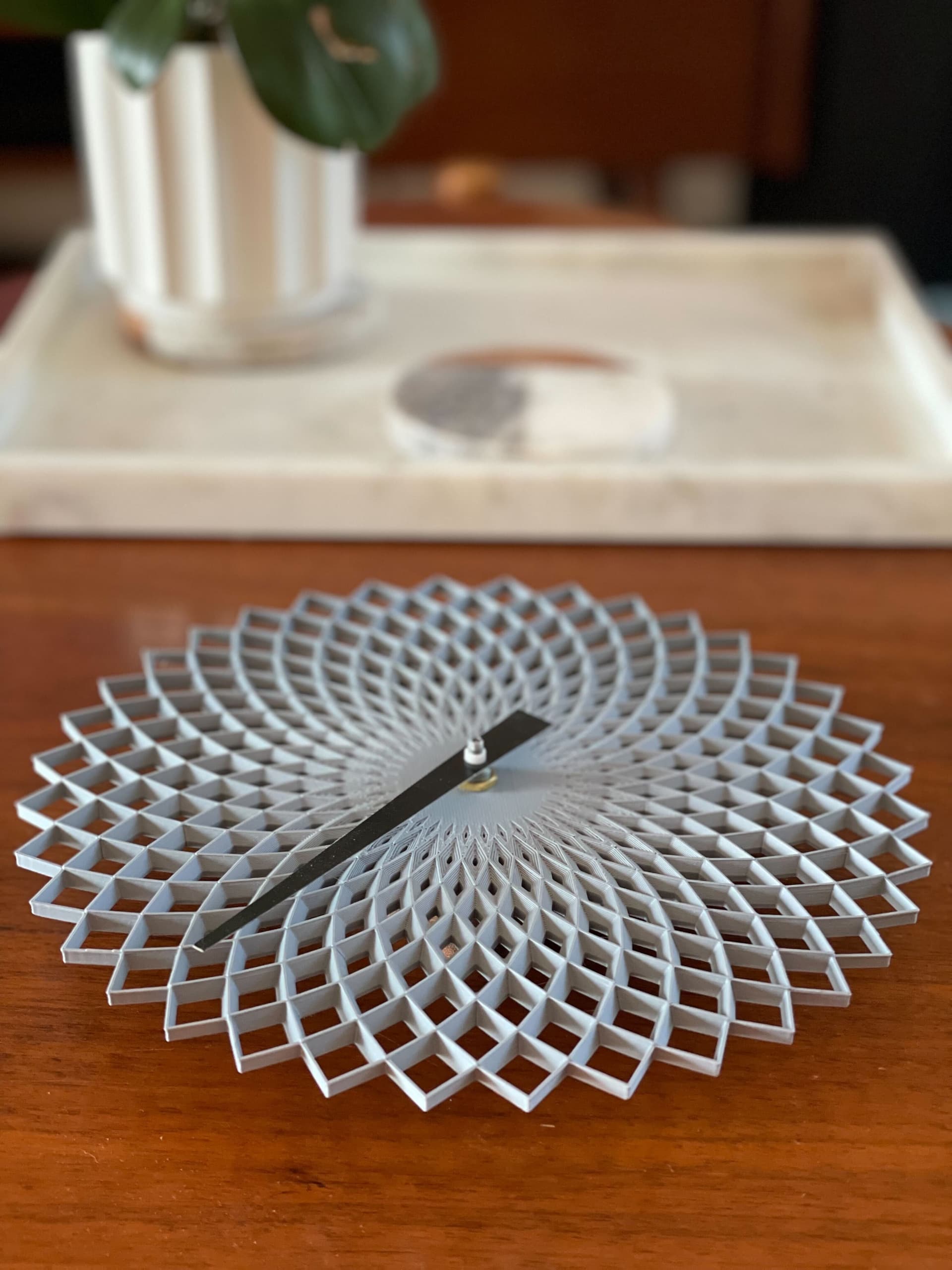

Added some classic ‘attractor’ algorithms, panel frame improvements, and I filled in for a missing surface area output with a centroid.
I took these updates for a spin with my 3D printer…
Download LunchBoxG2 Alpha v0.0.9 here
