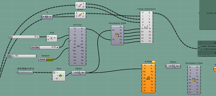

In Rhino 8, I cannot configure the annotation style types; they remain at default values.
I cannot set my styles, which is making the work complicated.

Hi Night -
The Grasshopper file that you posted does not correspond with the screenshot…
The file that you posted seems to work just fine?
Hi @ZY_Night,
All annotation components should have the ‘Style’ input and output here.
If is not your case please update Rhino.
I want to adjust styling to change the size, but TS is not the parameter I intend to set.
Hi Kike Garcia, my Rhino 8 is version 8.14 , which doesn’t have this input port. May I ask what version you’re using?

Hi Night -
The current stable version is 8.20.
I see the As
input in your image.
This is the default Aligned Dimension component in 8.20:
When you switch to full names:
Thinks,I will attempt to use Rhino 8.20
