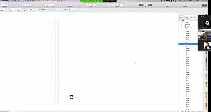

So, what he does is manually adjusting the order of layers (and sublayers?) in corel . This seems to translate to the lasercutter, which is rading the corel file…
here is a screenshot:

so here is the order in which he sets them up ( please excuse poor drawing with my mouse…)

well, Ideally it would work like this:
  1. cut inside curves (blue), starting left top, going down for the first element (every blue line inside the first red contour)
  2. at the bottom of the element move right to the next element, cut the first blue line of the second element, move up to cut the rest of the blue lines inside the second element.
    3.At the top move right to the next element, then down again…
    4… until we end up having cut all blue lines for the first row. (that would be in the top right corner…)
  3. Start with the outer lines red, beginning in the top right corner (where we finished…) and work our way back to the left side cutting out every red line…
  4. move to the next row and start again.
… it is important to cut out the inner lines first, otherwise the elements might move when the outline would be cut first…
