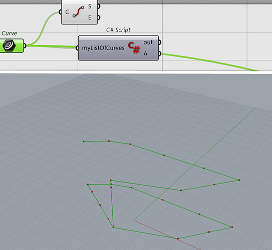

Hi anyone may help me on a c# script?
I am trying to create a script which will be able to joincurves which are coplanar and intersect each other…
I have tried to use the joinCurves method but i don t understand what the IEnumerable parameter is.
here is my script :
List<Curve> myListOfNewCurves = new List<Curve>();
Plane plane = new Plane(point, vector);
for (int i = 0; i < myListOfCurves.Count ; i++)
  for (int j = 0; j < myListOfCurves.Count  ; j++)
    if (myListOfCurves[i] != myListOfCurves[j] && Curve.PlanarCurveCollision(myListOfCurves[i], myListOfCurves[j], plane, 0.1))
LineCurve joinedCurve = new LineCurve(myListOfCurves[i].PointAtStart, myListOfCurves[j].PointAtEnd);
myListOfNewCurves.Add(joinedCurve);
A = myListOfNewCurves;

Could you please show an example of how to use the joincurves method
i wrote this but it seems to be wrong (I don t know how to deal with IEnumerable type…):
Curve joinedCurve = Curve.JoinCurves(myListOfCurves[i], myListOfCurves[j]);
My aim is to to be able to join curves which are coplanar and contiguous.
so i should have a set of two curves as shown below:

This is not a trivial work as one curve belongs to 2 planes. So my guess is you need to use each 2 times. Planes could be made using the intersections.
What you show is not coplanar curve but aligned ones.
So at the end you ll have to use join curves and then split at kinks.
You could use Ienumerable with a foreach.

Hello
here is a script that join curves then split then when there is not a continuity in direction.
  private void RunScript(List<Curve> myListOfCurves, ref object A)
    Curve[] cs = Curve.JoinCurves(myListOfCurves);
    foreach (Curve c in cs)
      List<double> lst_discontinuities = new   List<double>();
      double t0;
      double t1;
      double t;
      c.NormalizedLengthParameter(0, out t0);
      c.NormalizedLengthParameter(1, out t1);
      if (c.IsClosed) lst_discontinuities.Add(t0);
      while (c.GetNextDiscontinuity(Continuity.C1_continuous, t0, t1, out t))
        lst_discontinuities.Add(t);
        t0 = t;
      if (lst_discontinuities.Count > 0)
        Curve[] curvesSplittedAtDistcontinuity = c.Split(lst_discontinuities);
        myListOfNewCurves.AddRange(curvesSplittedAtDistcontinuity);
      else
        myListOfNewCurves.Add(c);
Test joinCurves LD.gh (6.4 KB)
From that
You get that
You can them test if there are on a plane. But this algorithm doesn’t necessary output planar curves.
