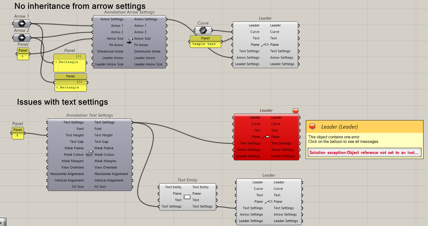

Hi! I’ve been trying the new Rhino8 annotation tools. I have some issues with the Leader component:
- It doesn’t seem to inherit anything from my Arrow settings (arrow size or arrow shape)
- It seems not to accept any Text settings unless (can’t explain why) it goes through a fictive text entity first.
Here is the result for first block
Do you have any help/recommandations?
Best
Quentin

Hi Quentin,
I’m seeing issues with changing the arrow size as well, i’ll investigate a bit and get back with additional info. Thanks

Here is the Youtrack RH-81800, should be an easy fix.
