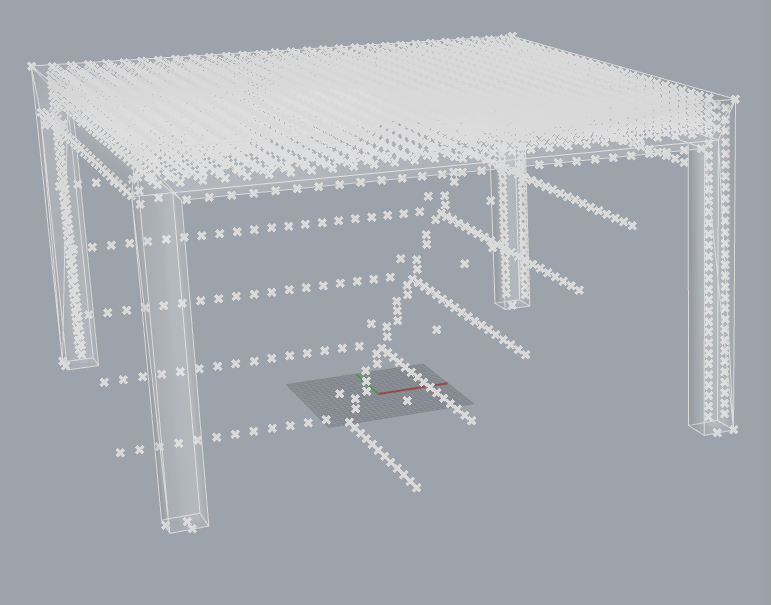

Hi everyone
I am facing a similar issue.
For a list of points (length = 1500) I want to check wether each point is inside a list of breps (let’s say 500). to speed it up, I want to merge the individual breps so I don’t have to loop through every brep for every point. I do this by merging them into one:
oneSpaceMerged = Rhino.Geometry.Brep()
for item in listOfSpaces:
oneSpaceMerged.Append(rs.coercebrep(item))
When I now check wether a testpoint is inside the merged brep, it gives me strange results.
It works well when I test it with the individual spaces.
It works like 90% when I merged the spaces into one. At certain spots, it does not recognize that the pt is inside the merged brep although it is. When I move the point just a little bit, it again returns true.
print oneSpaceMerged.IsPointInside(testPt,tol,True)
any idea of how to solve it?
pls find example file attached
Uploading: ptinsideTest.3dm…
ptinsideTestGH.gh (7.5 KB)
thanks a lot!
Hi @Maximilian,
I doubt the internal function was written with disjoint Breps in mind.
– Dale
