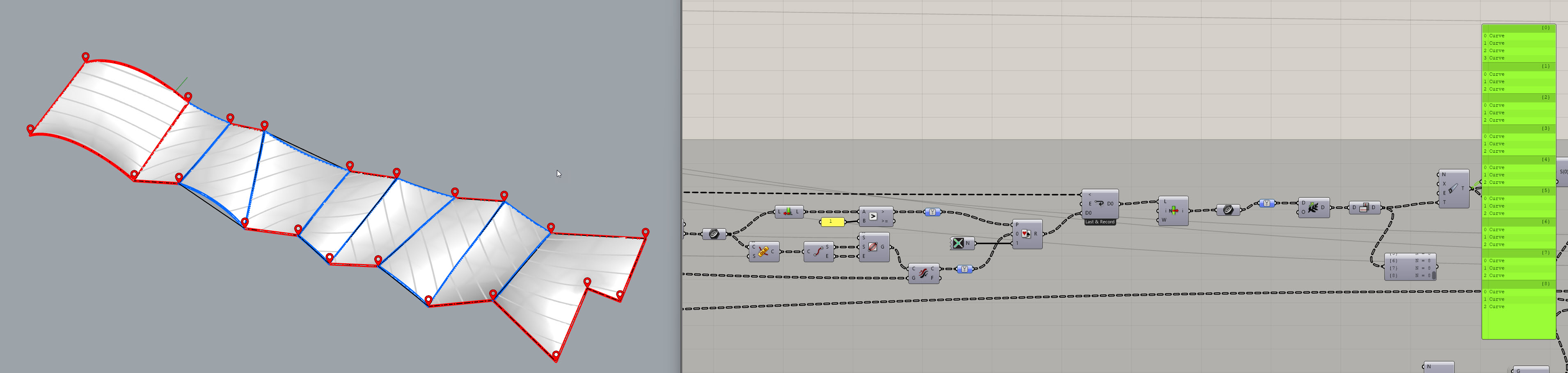

Is Anemone able to process trees?
I really don’t use Anemone often, and, while it is kind of working with my tree input, it seems to produce a lot of duplicate results, useless branching… proportional to the number of branches in my input.
250911_PROG_Anemone and trees.gh (92.4 KB)
So my question is : was Anemone ever designed to work with trees, or just with a flat input ?

It does handle trees but maybe not how you are thinking it will?
It does something strange to the data structure that I don’t understand…
This is a fun script that creates a branching pattern similar to leaf venation…
Each loop, it takes the branches (lines) and decides whether to cull them, split them and which direction they should go in and creates new branches which get fed back to the start of the loop.
It sounds like you want Anenome to loop once for each branch in your data tree whereas I think what happens is the whole tree of data goes through the loop. I might have misunderstood what you want though.
AnenomeLeaf3a.gh (41.4 KB)
I think that you don’t really understand what’s going on in the loop.
Curves are created by intersection of a given surface with successive cylinders.
This yields a variable number of curves that I first filter for being on one side of a plane, but the resulting curves could be of any number ; I just don’t want there to be 2 curves.
If you flatten the exit condition as you did in your version of the definition, it makes no sense, because this test is meant to be done for each surface separately, thus the tree.
Yep, that’s exactly what is bothering me.

Anemone Loop End input wants a single boolean: that boolean decides if the iteration continues or not (if the iteration Counter has not already reached the number of repeats) and if another iteration will happen, it will go through your whole D0 input data-tree
one way you might maybe tweak the whole thing, is to add a second loop input (D1) that loops all the 3 booleans that now are used as Loop End
and also implement a selection system that, if one of those D1 input is already True, data in that corresponding branch is just sent to next iteration “as it is” without going through the grinder
at the same time, you need a Mass Multiplier with flattened input to handle the Loop End

Hi Folks, thank you all for your inputs !
Anemone DOES work with trees and the tree input in the “EXIT” input of the “Loop End” component was indeed messing things up.
My conditional statement now only replaces the looping data by a null if the condition is not met.
For those who wonder, this algorithm is meant to perform patterning of textile membranes where the seams must be geodesics and the widths of the patterns must be close to a certain value (just a bit less than the fabric roll they will be cut out from).
