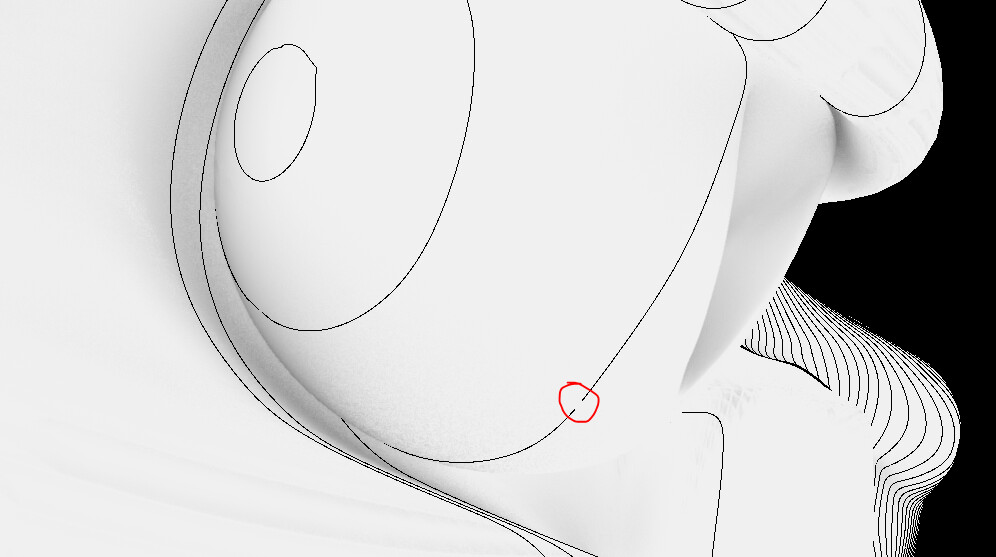

I am creating a sliced model from a crazy polysurface (result from quadmesh-to-SubD-to-Nurbs):
Polysurface is valid and no naked edges are present other for the ones that that are supposed to be naked (marked in image below):
When I run the Intersect command to generate a curve from the polysurface and the planar rectangle surface, I get a curve that crosses itself at this particular plane/surface location:

Hello- for now, set the document tolarance to .0001 and then intersect. (DocumentProperties > Units page)
Thank you Pascal,
I should have included that in my topic entry: I’ve been tweaking that setting along with the Mesh options (setting it to custom, increasing density).
The incomplete intersection seems to work better now however unfortunately I still get the self-intersections.

At .0001, there are no self intrersections in the curves here when intersecting the plane and the polysurface - is this correct:
sculptureslicing_Curves.3dm (97.9 KB)
Thank you for your time and responses @pascal
Yes - the file you shared does not reproduce the error.
At this point the ‘bug’ is a mistery to me.

My guess is the problem arises because the intersection just grazes a surface edge - passes within .001. Just the lower of the two faces there at the goofy intersection curve fails to find an intersection at all at .001 but gets the right answer at .0001. Anyway, I’ll get the example on the pile for the developer.
RH-71915 Surface Surface intersection - incorrect result
