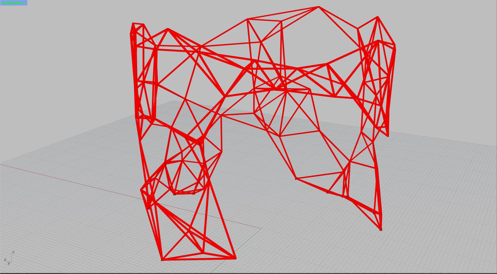

I’m trying to test out Kiwi!3D for the first time and got this error on the IGA solver:
This is the corresponding geometry that returned the error:
This is weird because I was able to get it working with a much smaller number of lines in Layer 01 of the attached Rhino7 file, seen here:
This is my expected result. All I did between the first and second image was I referenced a surface to generate the lines, whereas in the first image, I constructed the lined manually. The referenced surface is in the Default layer of the attached Rhino file.
How can I fix this issue? Or is this issue fixable? Any help is appreciated!

Hey, there are some beam input curves with length zero. If you remove them, it should be fine.
