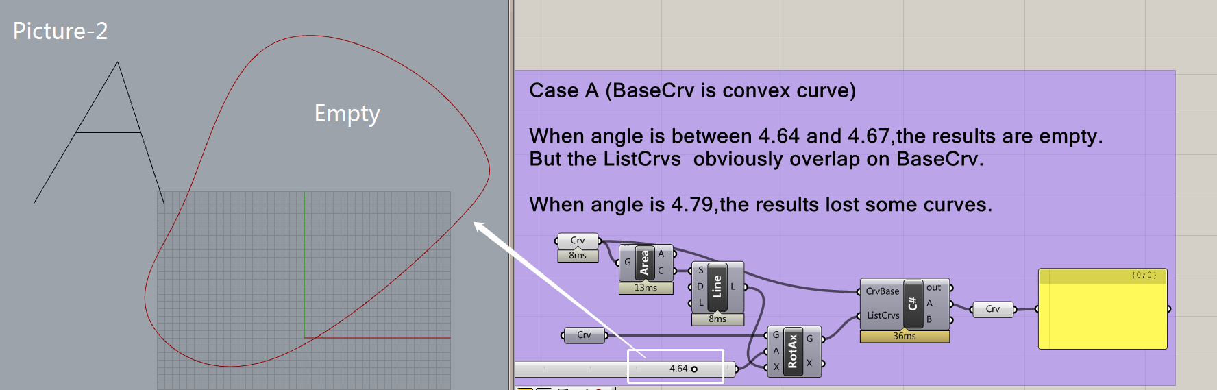

Case A (CrvBase is a convex curve):
When angle is between 4.64 and 4.67,the results are empty.But the ListCrvs obviously overlap on CrvBase.(picture-2)
When angle is 4.79,the results lost some curves.(picture-03)

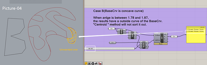

When anlge is between 1.78 and 1.87,the results show an unwanted curve outside CrvBase as a “wanted” one.(picture-04)
"Centroid " method will not sort it out.

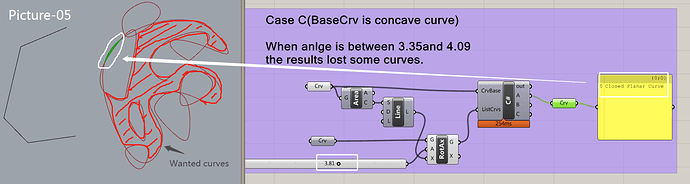

Case C (CrvBase is a concave curve):
Unluckily,when anlge is between 3.35 and 4.09,the results also lost some curves.(picture-05)
