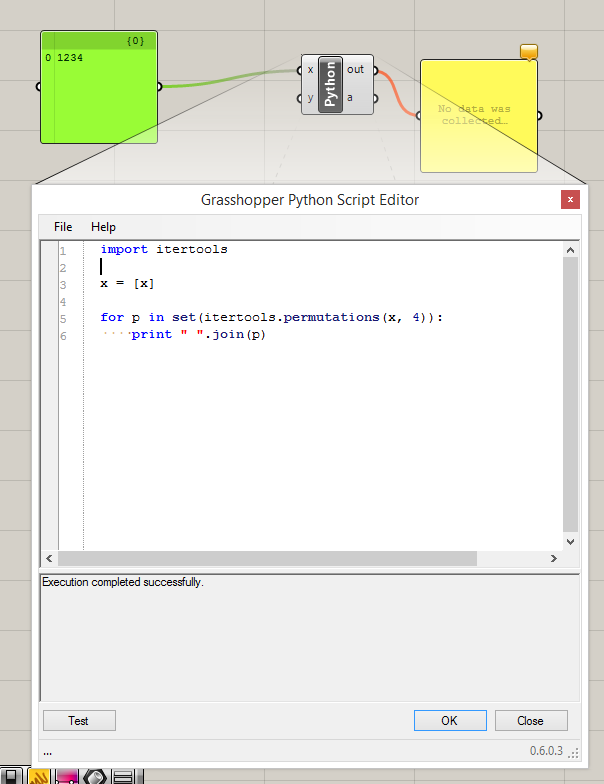

Thank you for the answer! Thought that scripting would solve it; unfortunately, I am less than acquainted with that… So I was wondering how to set up the component. How can I set it to input a variable given in an outside panel? (see image)
Thank you again!

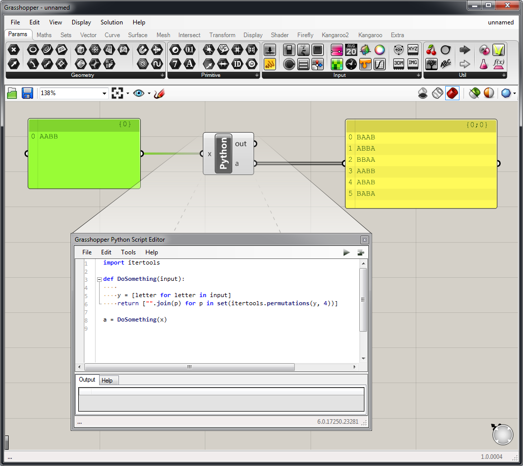

Hi @Pietro_Pedone, below seems to work:
_
c.
It’s not elegant, but this works.
permutations.gh (12.8 KB)

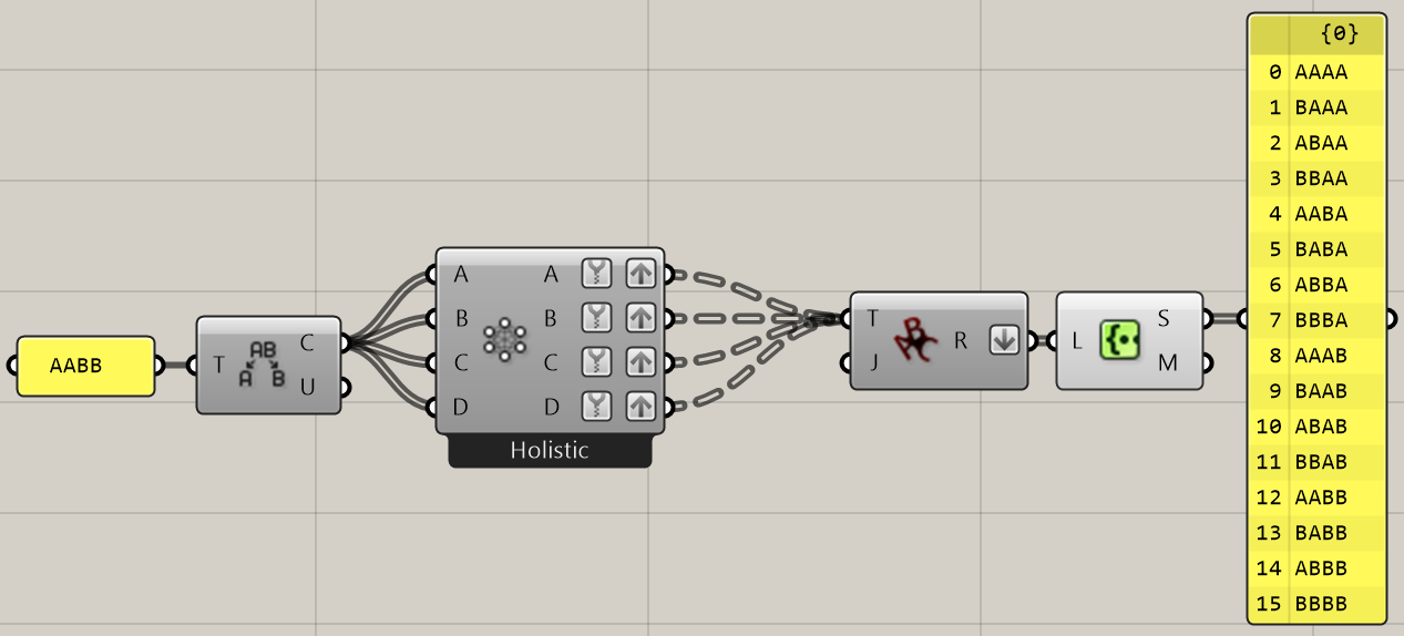

Wow, thank you both, @DavidRutten and @clement, very helpful! I’m just uploading this in case that someone else has the same question: here’s how they work side-by-side, clement’s (top) and David’s (bottom)

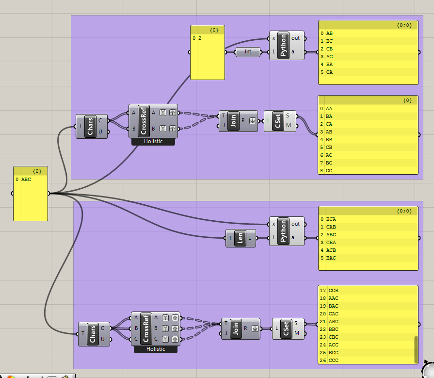

The solution posted by @DavidRutten appears to be doing combinations with replacement.
We also had a thread over on the Grasshopper forum covering several approaches to this (also using GHPython). I imaging the examples provided there might help to answer these queries
