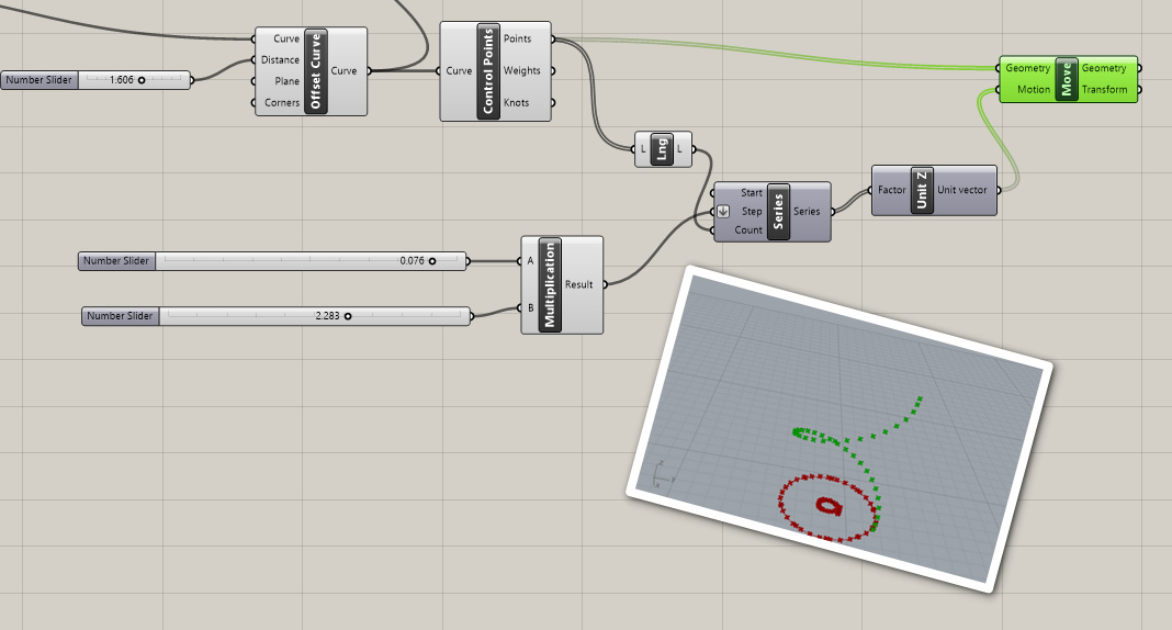

Hi, i am trying to move poins of a Z oriented spiral in series but not being able to do it. Whenever I try to move it on the Z axis it moves it regularly with every point… I want to move each point further down a little bit from each spiral.gh (8.5 KB)

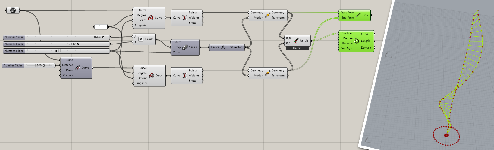

Check this out…
spiral_rev1.gh (11.6 KB)
I added the component for the list length of the points to set the count number for the series.
ALSO: your curve has a double point at the start wich caused the wierd starting trail
HTH
