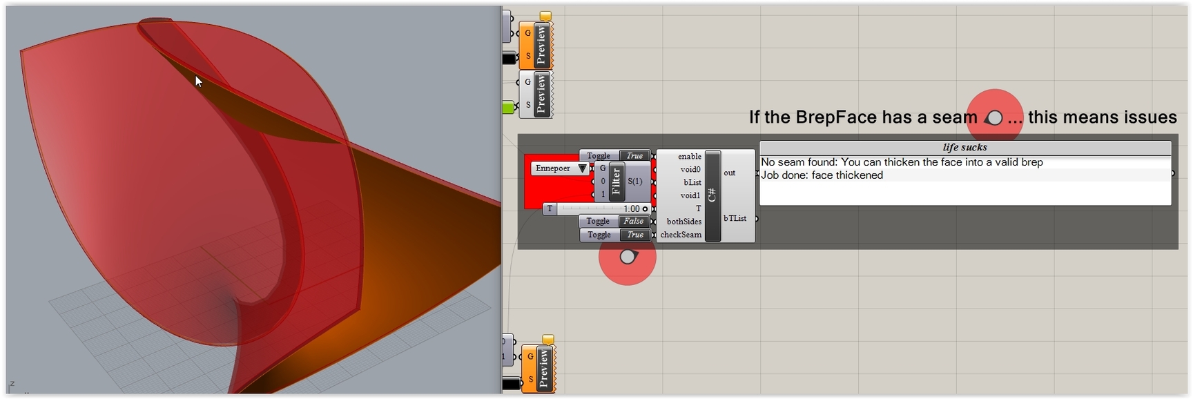

As LB does the Enneper surface you are deep into a rabbit hole. The bad news are that R SDK doesn’t provide enough Methods (or extended info) to deal with invalid breps.
See attached (it’s obvious why R fails: spot the seam).

And this that detects a seam (that means issues: most propably an invalid thickend brep):
Surfaces_4C_MonkeyEnneper.gh (51.6 KB)
But R is a surface modeller, meaning that this self intersecting result is OK (not allowed in solid modellers):
