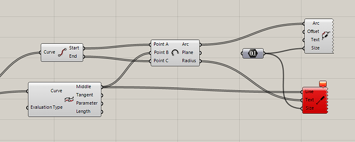

All my arcs show degrees, but I want radius and I can’t see what I’m supposed to use to get that:
I even tried this, which seems a bit hacky, but I couldn’t get it to work either:
Just create a line between the center of the arc and some point on it. Should be enough.
I’m sorry, but I am very new at this.
Are you calculating the center point of the arc and then drawing a line dimension to that point?
So in other words, there isn’t a radius dimension in Grasshopper? I ask because the notation for the radius dimension is different. It’s a 45 degree angle line with an R in front of the value.
Could you please show those nodes with their full names, because I haven’t learned the icons yet.
Here you go.
rad.gh (7.1 KB)
Thank you very much!
