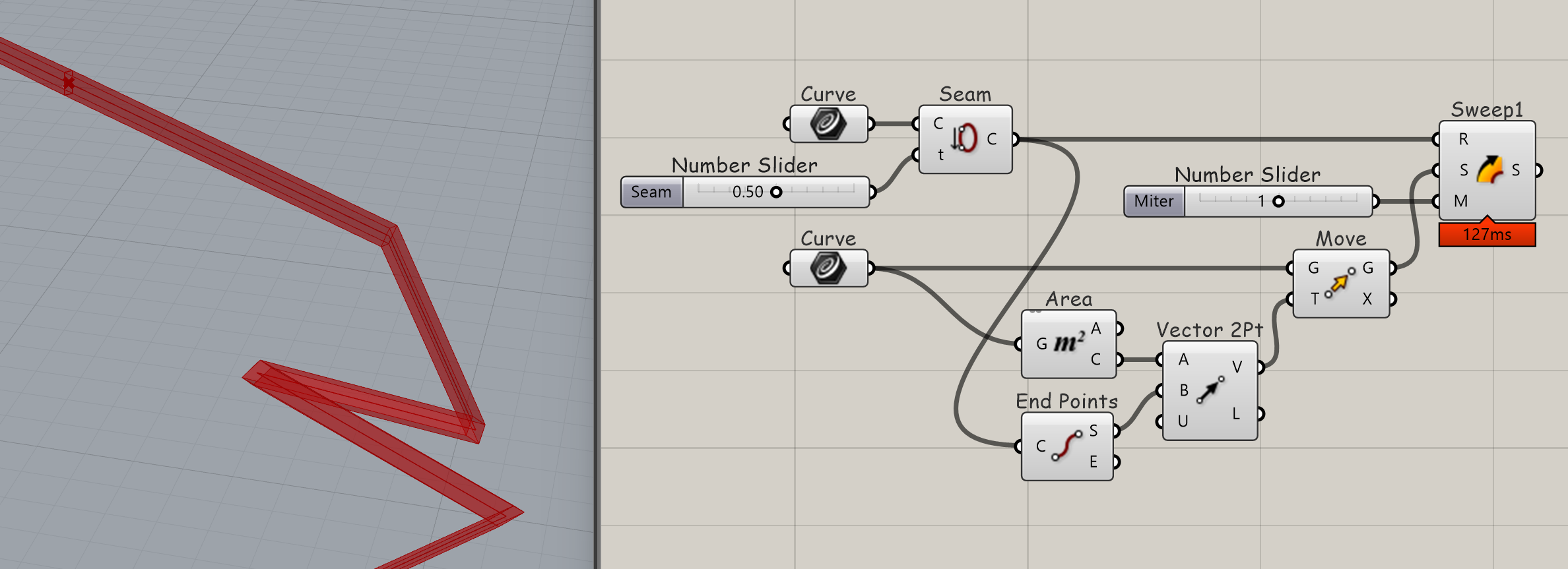

The profile needs to be placed at the start of the polyline, and the start of the polyine best moved to away from of corner of the polyline, because otherwise the Sweep will not miter there.
Thank you for your reponse Volker, But is it possible to have all intersections trimmed like this ? Sorry if I didn’t specify that in my original message.

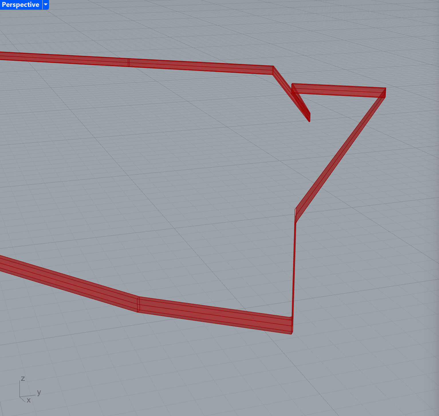

Becuase in my viewport i’t’s appeared like:
I have Rhino 8 SR22 2025-7-29 (Rhino 8, 8.22.25210.13001
Is mitering set to “trim?” If no, is the curve you using still a close polyline? Works on my end.
damn, it’s not working on my side
Which version are you using?
Version 8 SR25
(8.25.25314.11001, 2025-11-10)
Are there any other solutions besides updating my version ?

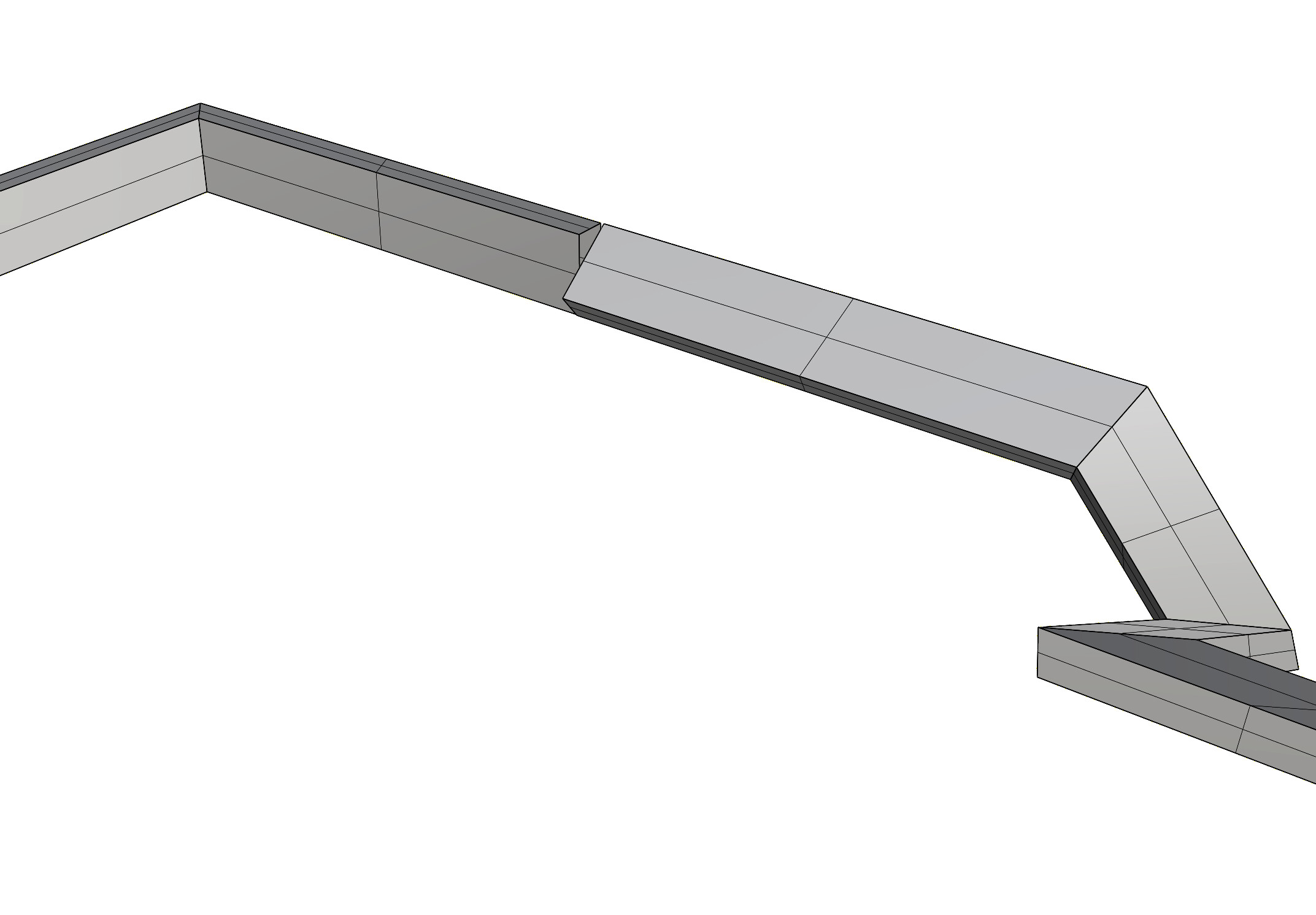

is this the geometry you’re after ?
i scaled the profiel by x3 to make the challenge more visible:
depending on your zick-zack the start and end rotation (profile around rail) will not match
sweep1_custom.3dm (3.0 MB)
as you can see here:
so maybe we need more context to solve your question.
what do you expect to happen at the seam ?
kind regards - tom

Thank you Tom for your time, but this is not the geometry I want. I need a geometry with the correct dimensions of the profile in the file I drop in my orginal file. In addition, I notice that your geometry shows changes in the orientation of the profile on the different segments of the rail, but I want to keep the original orientation of the profile uniformily along the rail.
Thank you for your time RenĂ©, but the result is not what I want, because the “rotate” option changes the orientation of the profile according to the segments, which is not what I want. I want to keep the original orientation of the profile along the entire length of the rail and have a trimmed geometry at the intersections.
so please sketch what you re after.
my approach is like cutting a wooden profile. the section is the same for all segments.
the angles of the cut are defined by the mid-angle-plane between two segments.
 because i use one loft per segment. but same can be done by extruding / spliting.
There is a difference between the geometry and how it is represented by the actual (nurbs) surfaces - so if you need a special representation, we can discuss this in a second step.
hope this makes sense.

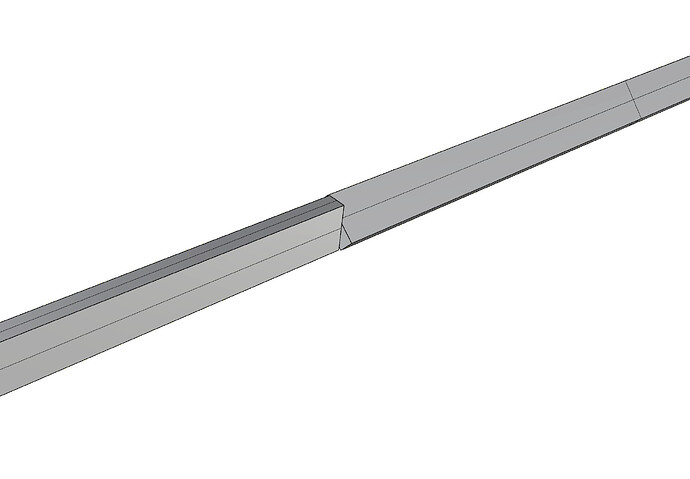

No, I meant that you want trim. Trim will rotate the profile against the curve frame so that it arrives at the corner in an orientation that can be mitered with the subsequent section of the rail. In my version this works:
and the fact that Raoul cannot upgrade his Rhino to the current version gives me suspicions about the type of program he is working with.
The rotate option of Sweep1 extrudes the profils along the rail and rotates the profile around corners to meet the starting profile orientation of the next rail segment.

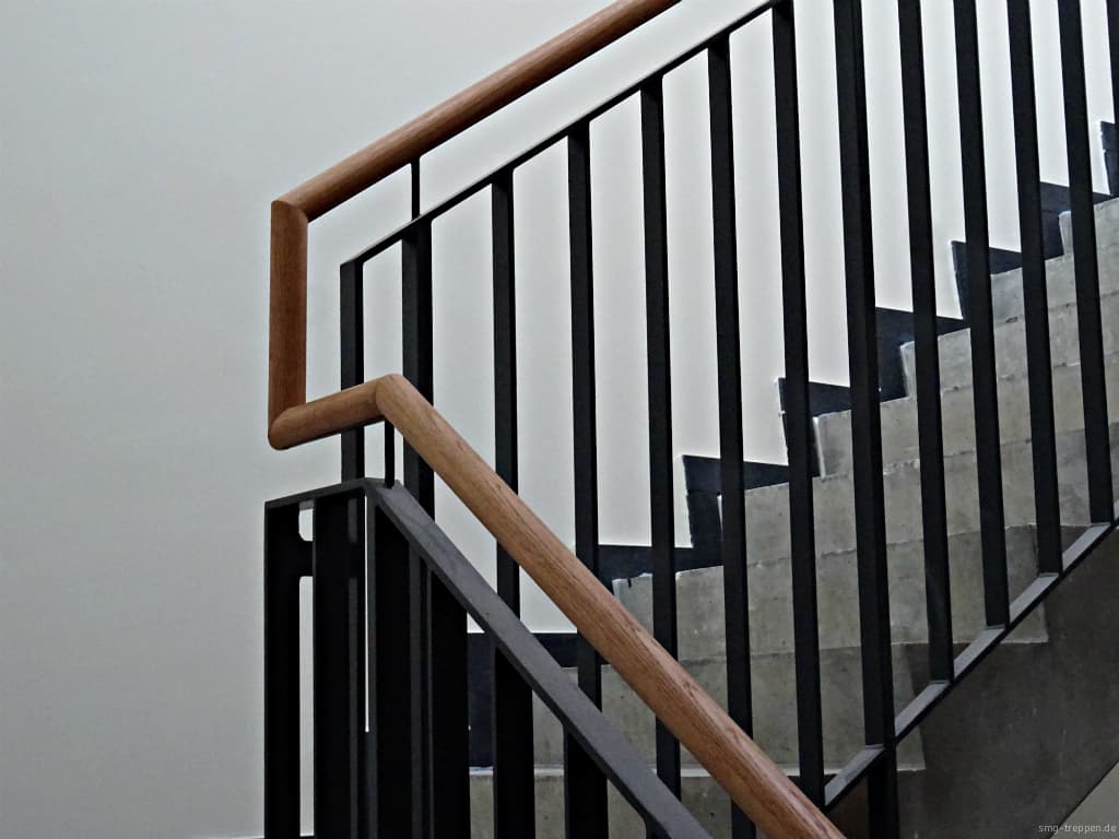

Or you can insert 90 degree connector segments.This is what is done with railings.
