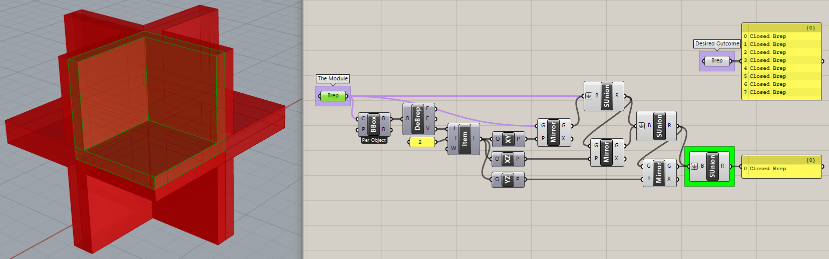

Hello everyone,
I have made a ‘Module’ piece, and I wanted it to move and transform to the orientation I have shown in the ‘Desired Outcome’ brep.
Thanks in advance for your help.
Ciao.
TZH
2021.06.29 - Oreinted Transformation.gh (76.8 KB)
Why make it difficult? It’s just three Mirror operations.
Oreinted Transformation_2021_Jun29a.gh (65.0 KB)
P.S. You could replace Merge with SUnion (three times) and get a single “Closed Brep”, but that’s not your “Desired Outcome”?
Oreinted Transformation_2021_Jun29b.gh (65.1 KB)

And how were those points created? In other words, how did those eight boxes get stacked as they are, and in arbitrary sequence (as noted by @maje90)? The premise of this exercise is seriously flawed.
Hello Joseph_Oster and Riccardo Majewski,
Apologies for not being clear enough. I will try to explain a bit more below.
I have taken the 8 ‘Transform Points’ as a reference of a box per se. The box can be of different scales. But regardless of the scale, I want the ‘Modules’ to be placed on the 8 edges of the box.
Now, for example, if I were to replace the edges with a solid cube instead of the ‘Modules’, the orientation would not matter. But as the ‘Modules’ I want at the edges has a character of being oriented I want them in the ‘Desired Outcome’, otherwise, it would not make sense.
I am attaching another screenshot for better understanding.
Hope it helps. Thank you for your time.
Ciao,
TZH

I give it a go with this:
2021.06.29 - Oreinted Transformation.gh (17.5 KB)
(internalized now)
Works like a charm, thank you :slightly_smiling_face:
The issue was poorly presented, no joke.
Oreinted Transformation_2021_Jul1a.gh (21.5 KB)
Riccardo (@maje90), your solution is a bit mysterious to me but I believe it would be slightly improved if you used only three points instead of eight to define the BBox.
Thank you for time and kind criticism, I will try to improve next time.
I interpreted this problem to be solved by using only transformations, so i pre-made all the 8 transformations in the same order of a box vertices, and then only at last applied the transformations…
OOPS! I discovered an error due to not specifying the Mirror plane correctly. For some reason (?), your “Module” brep is slightly below the World XY plane so required a proper reference point.
Oriented Transformation_2021_Jul1b.gh (19.9 KB)
