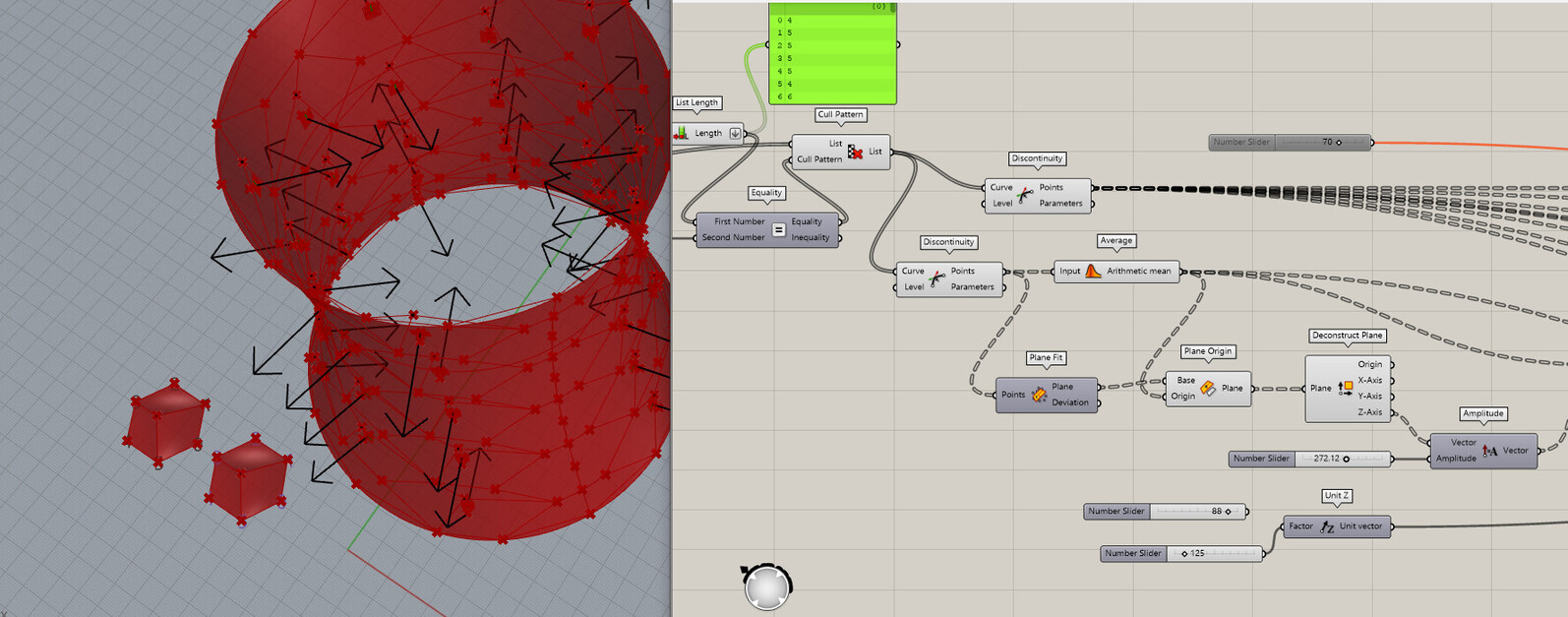

I’m trying to make hexagonal tessellation like this.
I made some isolated hexagons. The parallelograms come twisted though. I need to rotate flat parallelograms so that they form hexagon at the bottom.
I tried to map hexagons on a lofted surface. In order to evaluate the perpendicular vector outside, some vectors point towards the inside.
Please help.
HEXA PSEUDO PYRAMIDS_query.gh (30.4 KB)

Even on the lofted surface that I shared, the hex corners are not coming in the same plane. The hexagon obviously won’t be planar since the vase surface is curved.
I am unable to figure the way in my script. Two main things I need to achieve.
The quad panels should be flat.
The vector must always point outwards.
