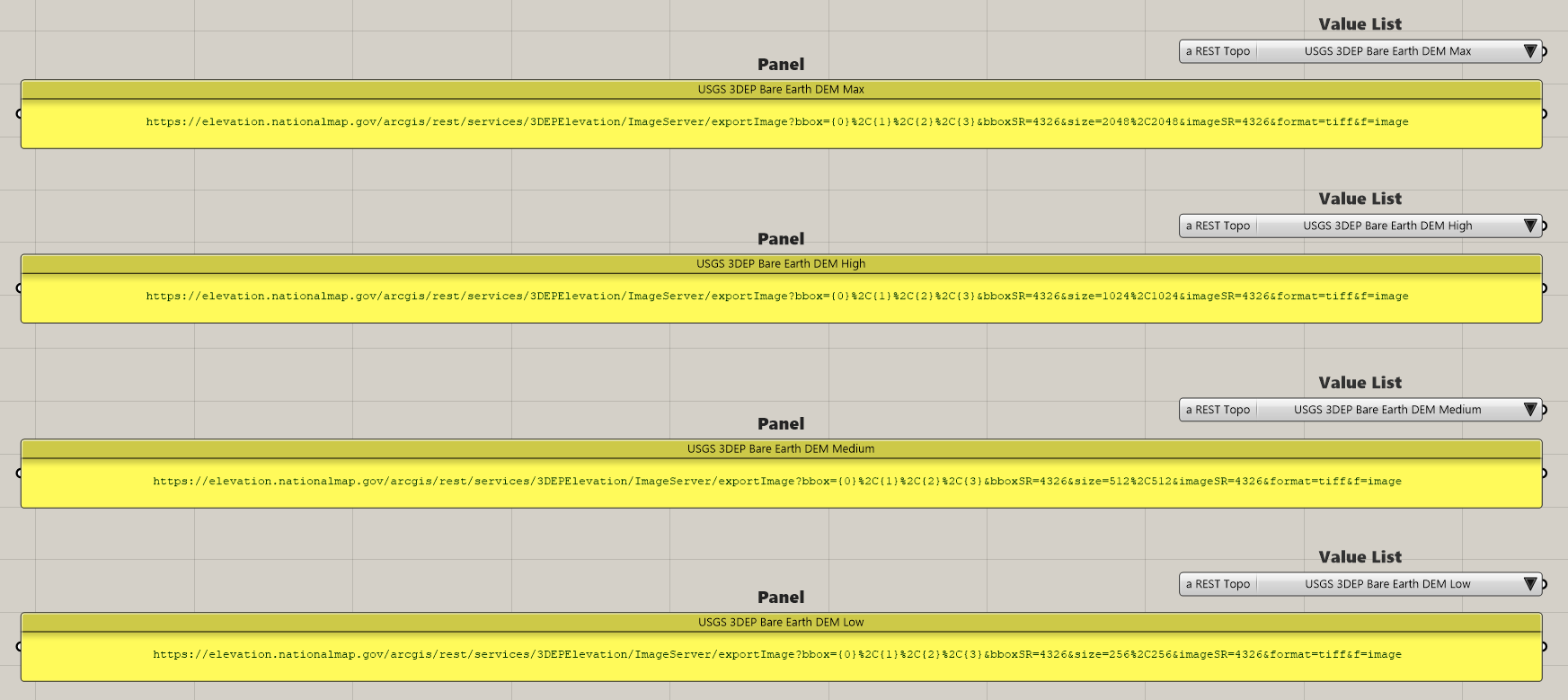

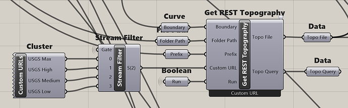

I just published Heron v0.4.3 (not a beta) which hopefully fixes the wrong URL bug you mentioned and adds an option in the menu to create a topo source dropdown like the one for raster sources. This dropdown can then be plugged into the new customURL input. The old Get REST Topography component was deprecated to allow this new functionality.
Take a look and let me know if it works.
-Brian
Hi Brian,
Thank you very much for the quick response and update. I was able to get that component working with no problem. For others reference:

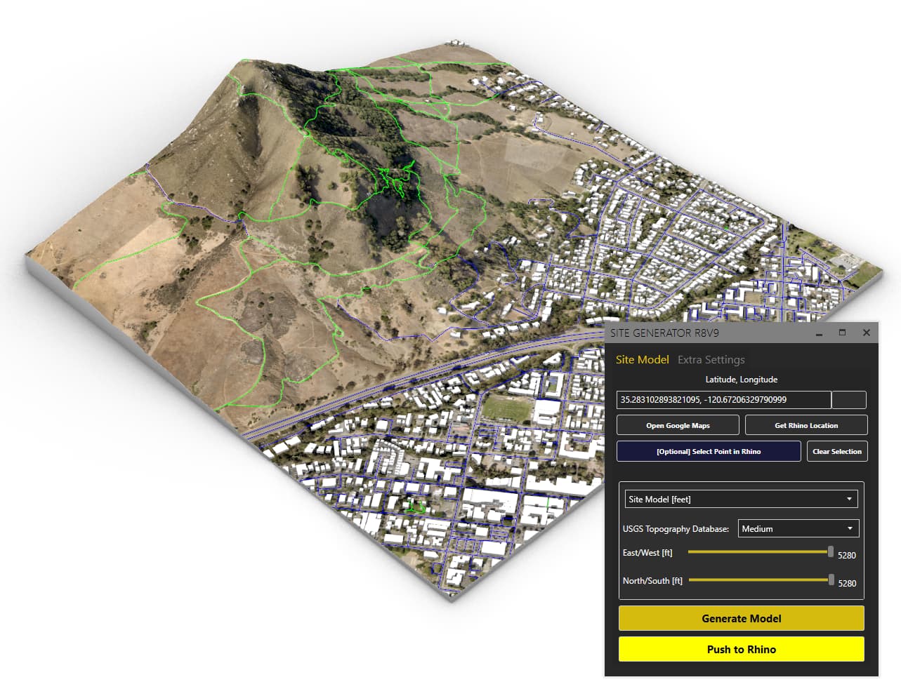

I figured it’s nice to see what others are doing with the plugin, here’s a screenshot of Heron + HumanUI I was able to setup for my team. I’m thrilled this works so well, thanks again Brian.

been working with heron for a while now and had a whole workflow for working with a topography going on. But it seems there`s an issue with the boundary input in the Get REST Topography.
the error is: Solution exception:Value cannot be null. (Parameter ‘path1’)
One week ago the script was working fine so I have no idea what it might be. The boundary however works with other components. Uploading script just in case..
heron_clean.gh (9.9 KB)

Hi Erik! thanks for the reply! Unfortunately the component is still not working for me (as the rest is) and getting the same error. Starting to think it might be something else, since it does work for you (ans used to work just fine a few days ago also for me) You know any possible workarounds to get a topography map that dont require this exact component?
Did you put a lib folder in the same directory as where your gh file is put?
yes I did. The other components as u can see in the screenshot are just fine - its the GET REST Topo the only acting oddly. Plus I get the error when connecting the curve.
Strange. Did you install Heron via the package manager?
just deinstalled-reinstalled it and nothing changed really
Did you try an other data source?
honestly nothing works :smiling_face_with_tear:
