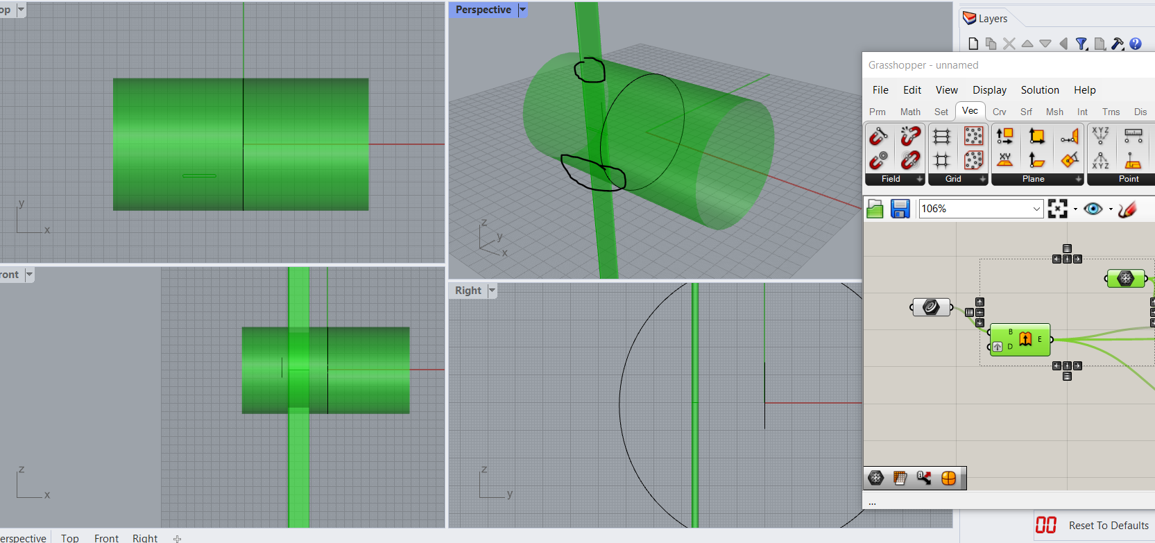

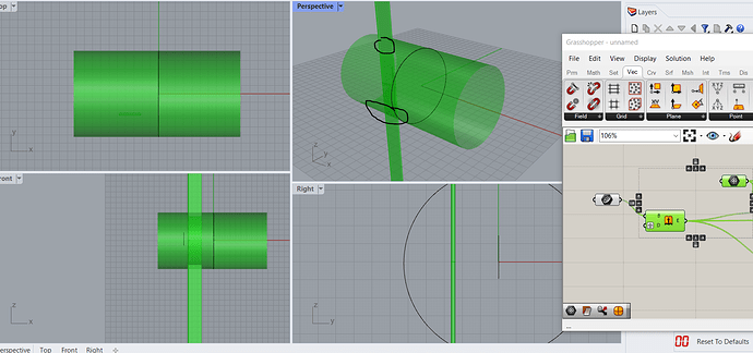

gap.gh (14.8 KB) How can I cut the slot form in the round cylinder? I need it to be a ‘through all’ gap. I tried dispatch but it only makes 1 gap instead of 2. Thanks!

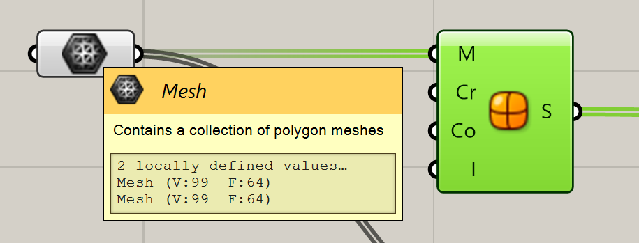

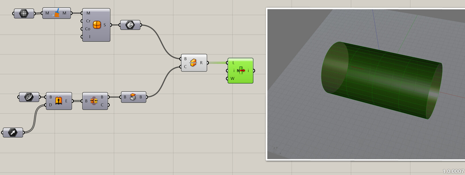

The mesh component stores two meshes which need to be joined and the cutter surfaces aren’t joined either…
gap_mrtn.gh (14.4 KB)
