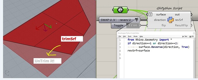

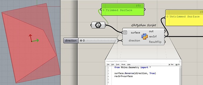

But about the second method of using Rhino Geometry API, the result of the Flip page about the trim Surface is wrong with an Untrim Surface? Is there a solution? I used the ScriptSyntax function for the same problem
By looking at your screenshot, I’ve noticed on line 2 that you set direction to either be 1 or 2, whereas - when you look at the documentation - , it should be 0 or 1.
I’m not sure, if this is the culprit though that causes the untrimming. It’s hard to tell without a file to take a look at.

My bad! For trimmed surfaces, you need to use the brep method Rhino.Geometry.Brep.Flip(), instead of the surface one.
A trimmed surface seems to be interpreted as a boundary representation.
if flip:
    brep.Flip()
revBrep = brep
I’ve renamed the component input to brep and set its type hint to a Brep for this to work.
