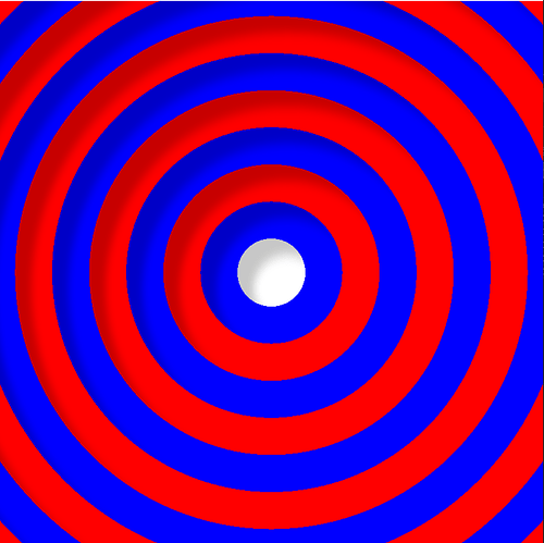

I add a lot of performance watchers, and I finally see that the “shadow” drawing takes around 5 to 9 ms for each level. Even if I remove “antialias”, the average gain is only 2ms. Maybe I have to look in this to optimize.
Confirmed. Drop shadow takes the longest. Also around 8ms per level. Looking into this now.
To be more specific, it’s the shadow blur:
Blurred shadow: 60ms for 10 rings

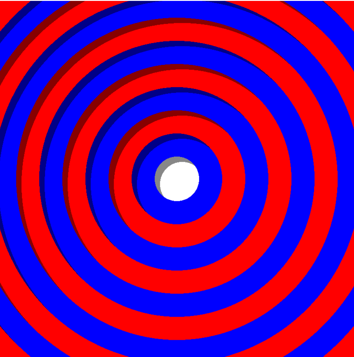

non-blurred shadow: 3 ms for 10 rings:
if (_drawShadow)
canvas.Save();
canvas.Translate(12 * _screenScale, 12 * _screenScale);
using (var shadowPaint = new SKPaint
Style = SKPaintStyle.Fill,
Color = SKColors.Black.WithAlpha(120)
canvas.DrawPath(path, shadowPaint);
canvas.Restore();
Right, but non blured shadow look « ugly »

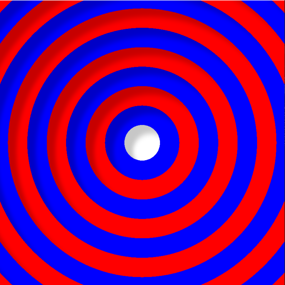

Yeah, GPU acceleration seems to be the best performing approach for this case. But it’s very simple to do on Windows. Create a context and copy pixels from the GPU to the CPU once done:
_grContext = GRContext.CreateGl();
The following code runs in approx. 15 ms for 20 rings and 1200 x 1200 px. Scaling down to 600 x 600 px takes 7 ms

Thank you very much ! I agree it is very simple, it is likely the same on macOS. just create a GRContext and copy (are directly write to) in an ETO Bitmap.
But it looks event simpler on Windows, as I can see you’re not forced to create all that MTLQueue, MTLBuffer and so on ![]()
Now I have to find a PC laptop to test it on windows…
I couldn’t find a way of directly writing to the bitmap from the GPU. The current version is relatively performant but it hits its limitations with increased amount of dropshadow effects. For your specific application, you could think of batching these calls and drawing them in one go. You could probably get away with three shadow passes, one for each ring:
Here is the latest, slightly more optimized version of my previous code. It runs on R8 .NET48 and .NET7

You’re right, drawing shadow in one pass instead of 3 reduce rendering time from 15ms to ~3 ms.
It is logical since I draw once vs 3 times before
But I have a problem for managing level shadow opacity this way… Each level have its own opacity when appearing, so the “one pass” drawing is ugly ![]()
Not sure I understand the issue. You could still have distinct opacities for each level of the menu with only three passes:
If I Draw a shadow for each level, I must do 3 passes (one for each level). It takes 15-20 ms, but in this case I can have différent opacity for each shadow.
If I Draw shadow in one pass (e.g for the whole menu, inclusing sub levels), it takes only 3-6ms, but in this case I cannot have opacity for each shadow.
What I mean by « a pass » is : one SKPath, one SKPaint. In 3 passes, three SKPath, three SKPaint.
The SKPaint is very time consuming.
And as I can have many sublevels animating (e.g one easing in, another easing out), sometime there are more than 3 shadow to Draw.
So in conclusion, using gpu still is the best way to get something animating smooth. And as you said, it is very simple to implement (simpler on Windows than macOS, I’ll have to check this)
