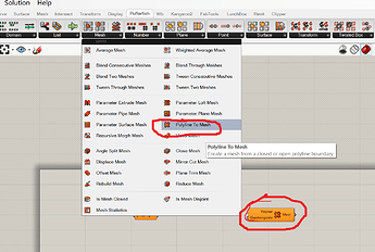

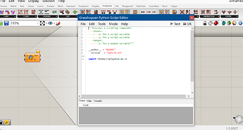

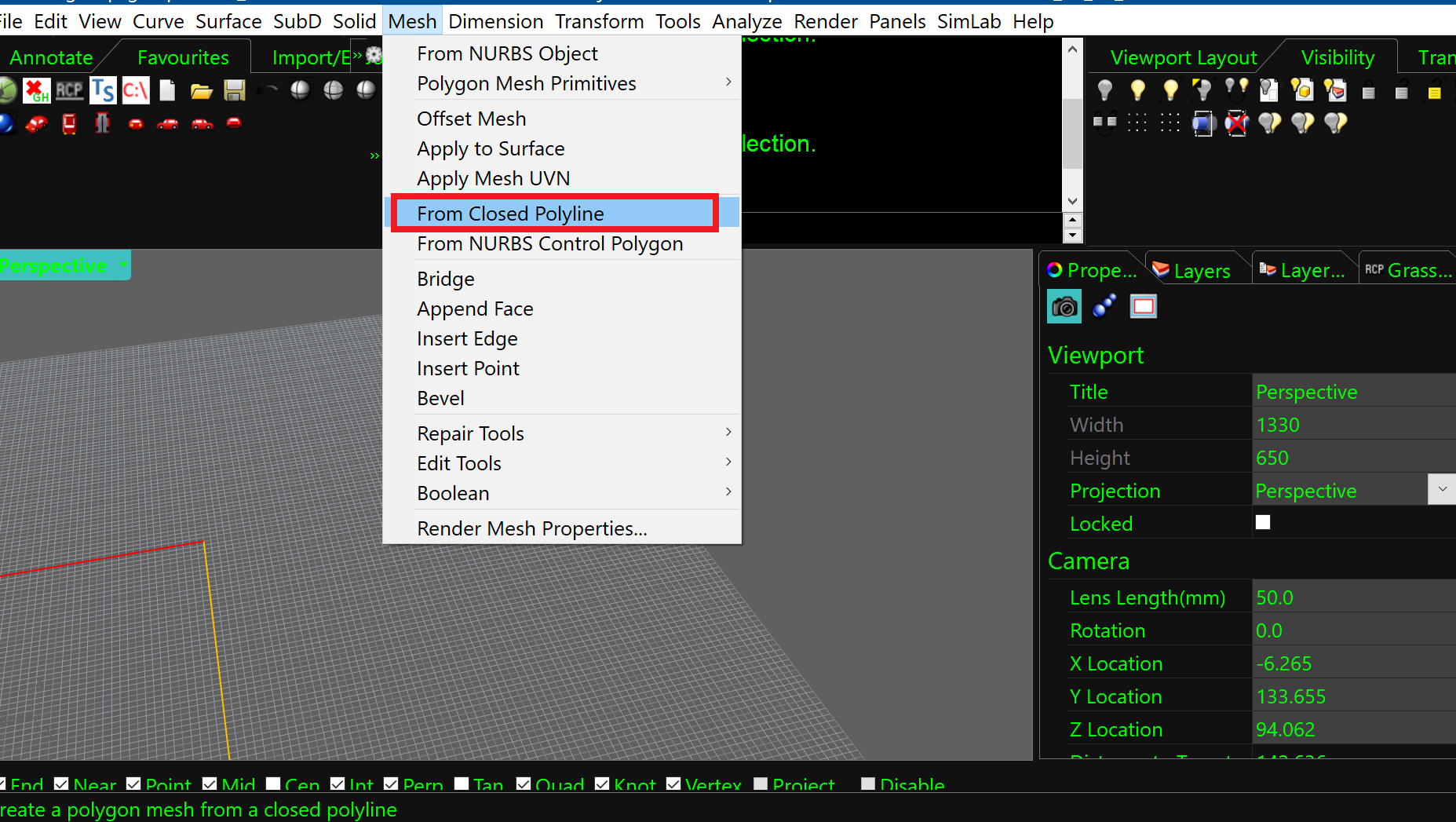

I am wondering if I can make a Grasshopper Python Component with the same functionality of [MeshPolyline] - (native Rhino command_Mesh from Closed Polyline), (I can find it in the Pufferfish plug-in, but can I just make it my own? ).

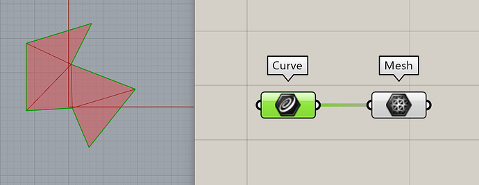

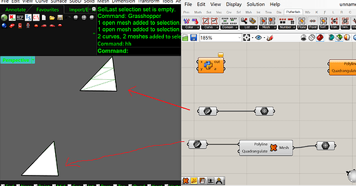

I believe you are talking about the first method in my screen shot, in which the triangular mesh has some internal edge, compared with the one created by"MeshPolyline",
