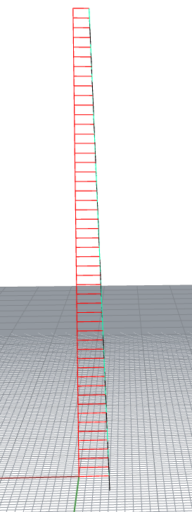

I am pretty new to Kangaroo2, and this is my first time writing here. I am trying to simulate a cable (black) that slides along the vertices (theoretical trajectory in cyan) of a slender beam-based structure (red) anchored on the floor.
By pulling the black inextensible cable down, I would like the structure to deform while the cable points slide along the cyan path.
This is my attempt with no success:

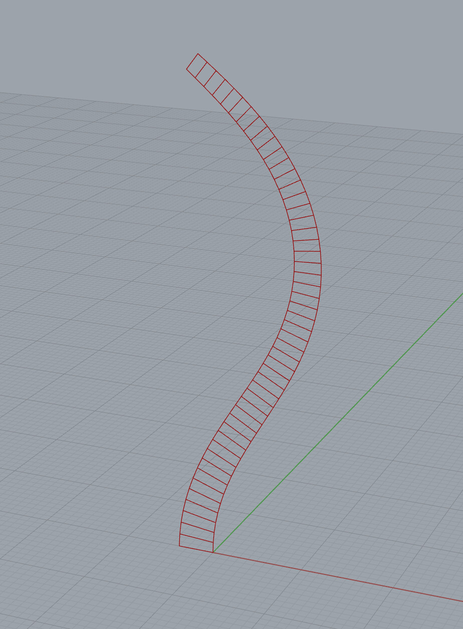

The relaxed structure looks like the one I sent before, but simply straight:
I do not have a picture of the expected fully deformed shape, since that is what I would like to obtain. I may look like this:
with a bit of difference in the curvature close to the base, since, as you also said, the cable is constrained by the boundary of the structure and that should affect the deformation.

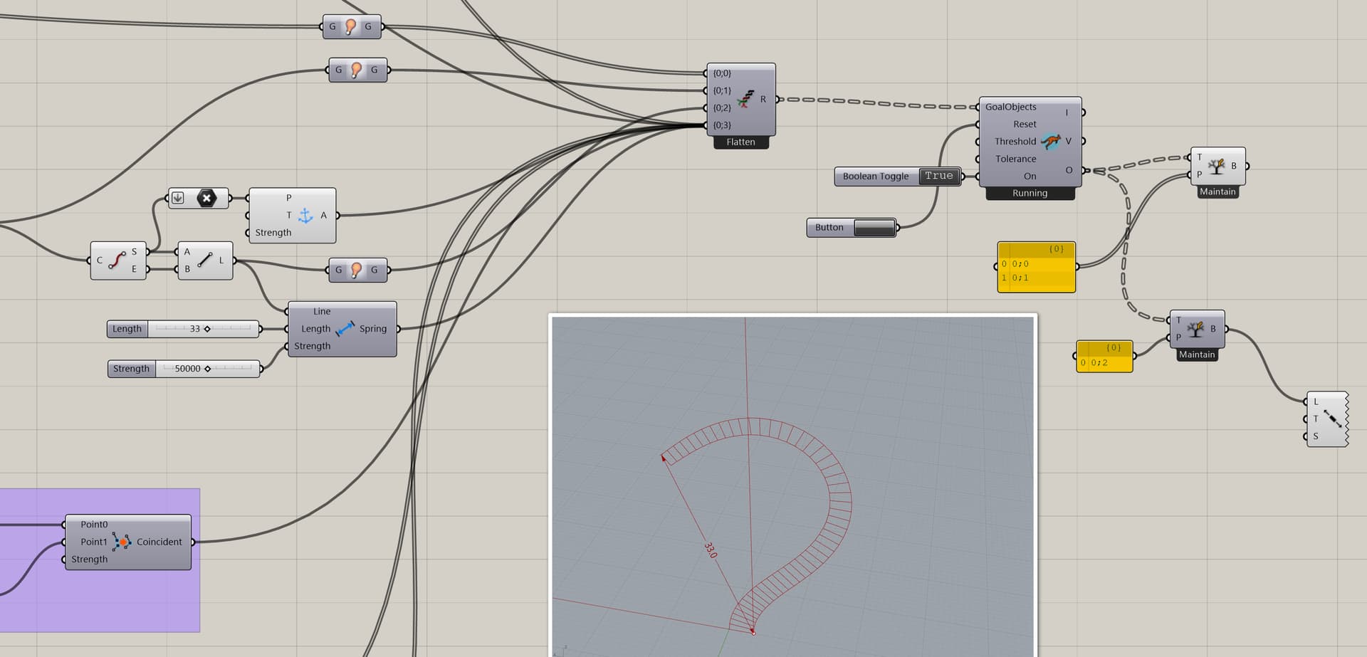

I had a chance to look at your file now. I’m not sure if I would use the Drag option to pull the structure downwards. A Length Line goal might be more useful.
To access the output a little easier and also unaffected by changing inputs, I’d put the Show goals in the first branches and then all other goals into one or as many branches as you wish.
pull-end-of-curve.gh (30.7 KB)

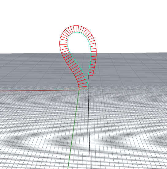

Here is my latest attempt:
OnMovingCurve_3.gh (28.8 KB)
Here it is very close to what I would like to obtain however the curve being dragged slides only vertically while I would like to have it to follow the deformed structure…

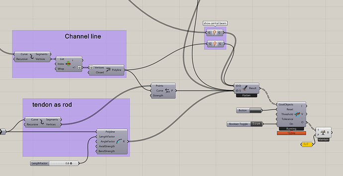

I think I understand now :slight_smile: You want to keep the tendon points on what you call channel line. You can use the length factor on the rod goal to pull the beam ends.
OnMovingCurve_4.gh (30.9 KB)
