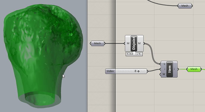

Have you tried a boolean union?
I was looking for a method that can be automated, which does not require manual selection of any different parts. Also, in some cases all these faces are one single mesh so there are no parts to boolean with. For this reason I need to delete individual mesh polygons being located inside the outer-most surface.
// Rolf
Dunno… SplitDisjointMesh will split non-joined parts of a single mesh into separate pieces. If the “outer” is indeed one contiguous piece, you could select it, invert the selection and Delete. SplitDisjoint is also in GH.
–Mitch
Yes, I have tried that, but one problem is that in some cases that mesh has “thickness” and thus there’s a joined inner surface as well. Using SplitDisjoint I get 8 list items, and the outer most surface is the 8th item in the list and looks like this ( that is, problem remains, since there’s that inner surface still inside) :

Well, then there might not be a good collection of tools native in Rhino to do this - some mesh repair software like Magics have a “shrinkwrap” function, which is more or less what you want…
–Mitch

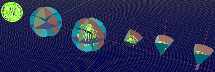

Hi Rolf
… Talking about performance, I tried your algorithm (nice idea BTW :slight_smile: ) with some changes that … might make it faster … not sure though. :confused:
Here is the idea: splitting the point cloud into smaller ‘volumes’ and then apply your ‘pipes subtraction’ independently to them.
In order to make it faster, for any volume we only use a single pipe axis direction,
and for easier calculation, we orient the volume so that the pipes axes are vertical.
we will also use ‘square pipes’ … but I think cylindrical pipes could be used too … not sure about the difference in performance.
TAI.3dm (1.0 MB)
Here is, more or less, how it should work:
  1. move the points to have the centroid in the origin
  2. splt the point into 24 sets ( see the ‘walls’ that divide the volumes )
  3. for each point set:
    3A) orient it so that its ‘central axis’ lie on the Z axis
    3B) purge the points by the ‘square pipes’
    3C) orient the remaining point back to their original orientation
Unfortunately my Grasshopper is very far from fluent … so I’ll stick to plain Python scripts … :blush:
This is the test script I used to … build the idea :wink:

        pset[ 18 + 0 ].append( pt )
      elif ( ay > ax ) and ( ay > az ):
        pset[ 18 + 1 ].append( pt )
      else:
        pset[ 18 + 2 ].append( pt )
# 21 22 23
    elif ( pt.X > 0.0 ) and ( pt.Y <= 0.0 ) and ( pt.Z <= 0.0 ):
      if ( ax > ay ) and ( ax > az ):
        pset[ 21 + 0 ].append( pt )
        pset[ 21 + 1 ].append( pt )
      else:
        pset[ 21 + 2 ].append( pt )
# debug
# for ix in range( 24 ):
#   print len( pset[ ix ] )
# rs.ObjectColor( rs.AddPoints( pset[ 0 ] ), [ 255, 0, 0 ] )
# rs.ObjectColor( rs.AddPoints( pset[ 1 ] ), [ 0, 255, 0 ] )
# rs.ObjectColor( rs.AddPoints( pset[ 2 ] ), [ 0, 0, 255 ] )
# rs.ObjectColor( rs.AddPoints( pset[ 3 ] ), [ 255, 255, 0 ] )
# rs.ObjectColor( rs.AddPoints( pset[ 4 ] ), [ 255, 0, 255 ] )
# rs.ObjectColor( rs.AddPoints( pset[ 5 ] ), [ 0, 255, 255 ] )
# rs.ObjectColor( rs.AddPoints( pset[ 6 ] ), [ 255, 0, 127 ] )
# rs.ObjectColor( rs.AddPoints( pset[ 7 ] ), [ 255, 127, 0 ] )
# rs.ObjectColor( rs.AddPoints( pset[ 8 ] ), [ 255, 127, 127 ] )
# rs.ObjectColor( rs.AddPoints( pset[ 9 ] ), [ 127, 0, 0 ] )
# rs.ObjectColor( rs.AddPoints( pset[ 10 ] ), [ 127, 127, 0 ] )
# rs.ObjectColor( rs.AddPoints( pset[ 11 ] ), [ 127, 0, 127 ] )
# rs.ObjectColor( rs.AddPoints( pset[ 12 ] ), [ 127, 255, 0 ] )
# rs.ObjectColor( rs.AddPoints( pset[ 13 ] ), [ 0, 255, 127 ] )
# rs.ObjectColor( rs.AddPoints( pset[ 14 ] ), [ 127, 255, 127 ] )
# rs.ObjectColor( rs.AddPoints( pset[ 15 ] ), [ 0, 127, 0 ] )
# rs.ObjectColor( rs.AddPoints( pset[ 16 ] ), [ 127, 127, 0 ] )
# rs.ObjectColor( rs.AddPoints( pset[ 17 ] ), [ 0, 127, 127 ] )
# rs.ObjectColor( rs.AddPoints( pset[ 18 ] ), [ 127, 0, 255 ] )
# rs.ObjectColor( rs.AddPoints( pset[ 19 ] ), [ 0, 127, 255 ] )
# rs.ObjectColor( rs.AddPoints( pset[ 20 ] ), [ 127, 127, 255 ] )
# rs.ObjectColor( rs.AddPoints( pset[ 21 ] ), [ 0, 0, 127 ] )
# rs.ObjectColor( rs.AddPoints( pset[ 22 ] ), [ 127, 0, 127 ] )
# rs.ObjectColor( rs.AddPoints( pset[ 23 ] ), [ 0, 127, 127 ] )
  ppts = []
  for ix in range( len( pset ) ):
    ppts.extend( purge( pset[ ix ], xfor[ ix ], xbak[ ix ], 15.0, 5.0 ) )
    print( '%d / 24' % ix )
# move points back
  for ix in range( len( ppts ) ):
    ppts[ ix ] += cen
# delete original points
# rs.DeleteObjects( gids )
# draw purged points
  rs.AddPoints( ppts )
main()
… for what it’s worth …
