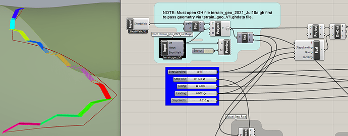

This is a quick and dirty hack, not a proposal! Similar to version terrain_steps_2021_Jul15b.gh from four days ago (though better than that). It uses the same number of steps in each flight of stairs. The number of flights is calculated based on ‘Steps/landing’ and ‘Landing’ length (two sliders).
It’s interesting to play with. I skipped trimming the extended landings for now.
UPDATE: Version ‘Jul19c’ fixes an off-by-one error causing misalignment and restores trimming of extended landings.
terrain_steps_2021_Jul19c.gh (46.7 KB)
(NOTE: Requires terrain_geo_2021_Jul18a.gh from earlier post.)

Next is a copy of terrain_steps_2021_Jul19c.gh from yesterday with a second Data Input to read the alternate ‘ShortWalk’ path. The ‘StepsLanding’ and ‘Landing’ (min. length) sliders are adjusted so the steps end at approximately the correct height and location.
These two parameters offer very little control of the outcome. Some flights are buried by the terrain while there are too many or too few steps for the path height. One wishes for a smarter algorithm.
terrain_stepsF_2021_Jul20a.gh (47.1 KB)
(‘terrain_stepsF’ designates FIXED number of steps per flight)

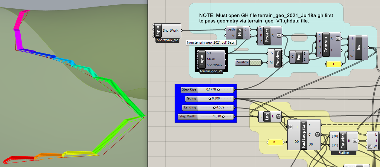

And last is a copy of terrain_steps_2021_Jul19a.gh from yesterday using the same alternate ‘ShortWalk’ path. The ‘Landing’ (min. length) slider is the only adjusted parameter. The result is arguably “smarter” but the four longest flights have 37, 31, 25 and 24 steps!
terrain_stepsV_2021_Jul20a.gh (55.0 KB)
(‘terrain_stepsV’ designates VARIABLE number of steps per flight)
Food for thought. Clearly, the total number of steps should be fixed. And maybe the landings should vary in length depending on the terrain?
P.S. This is ‘terrain_stepsV’ again but with a much shorter ‘Landing’ (minimum) value of 1.6 m. The four longest flights have 26, 17, 15 and 14 steps, though some bugs are evident where the path is nearly flat and the landings need to be much longer.
terrain_stepsV_2021_Jul20b.gh (50.7 KB)
