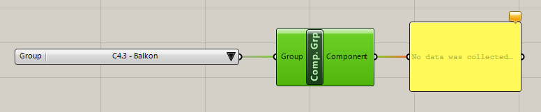

I noticed that the generated ValueList doesn’t give its output parameter.
Do I need to set all the items in ValueList as output parameters?
Is it being re-created every time the solution re-computes?

From the diagram, you item is the following:
“C4.3 - Balkon”
If grasshopper tries to convert that string into a number, it will output a null as that string cannot be converted to a number.
should be changed to:
for(int i = 0; i< groups.count;i++){
    grpList.ListItems.Add(new Grasshopper.Kernel.Special.GH_ValueList(groups[i],i))
