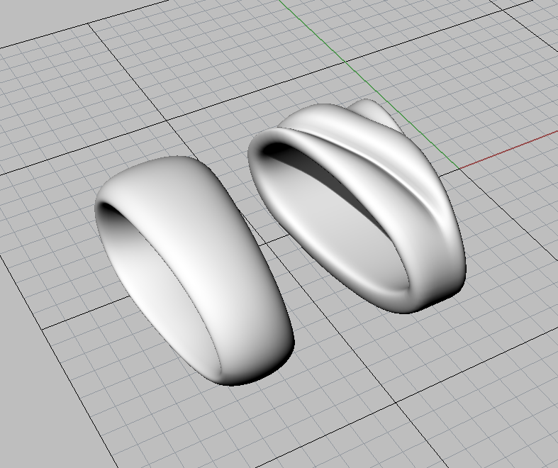

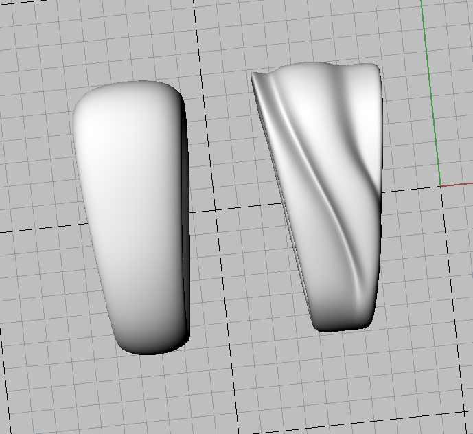

Photos of a quick and dirty sample in t-splines. Good luck.

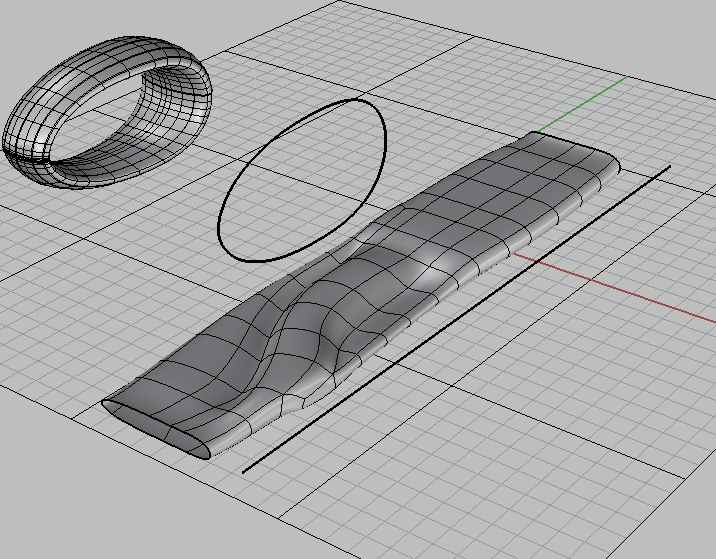

Here is how I made that bail in Rhino/Tsplines and maybe it might make you rethink your disinterest in t-Splines.

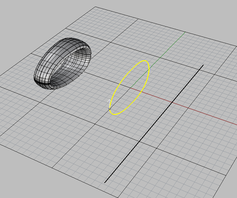

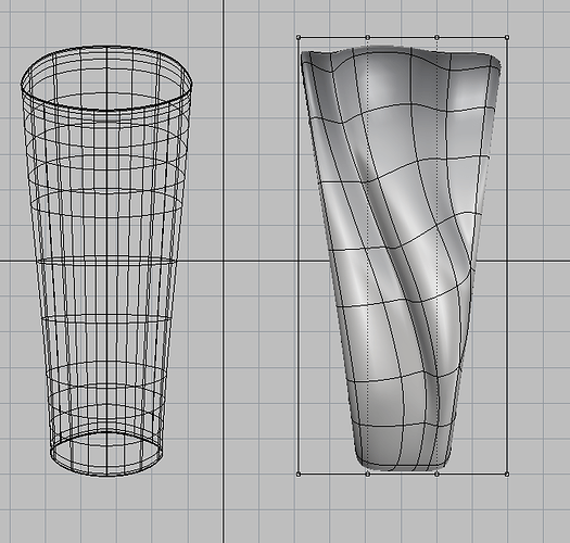

I extracted the curve from the centre of your bale, moved the closed curve seam to near the jump ring area and then measured its length and created a straight line the same length.
Now make your shape on the flat in t-splines. Much easier than working on a curve.
The flow command in Rhino works very well with t-splines as do many others. Turn points on for t-splines then flow from the straight curve to the bale curve.
Next use the t-splines bridge command to close the end off into a solid.

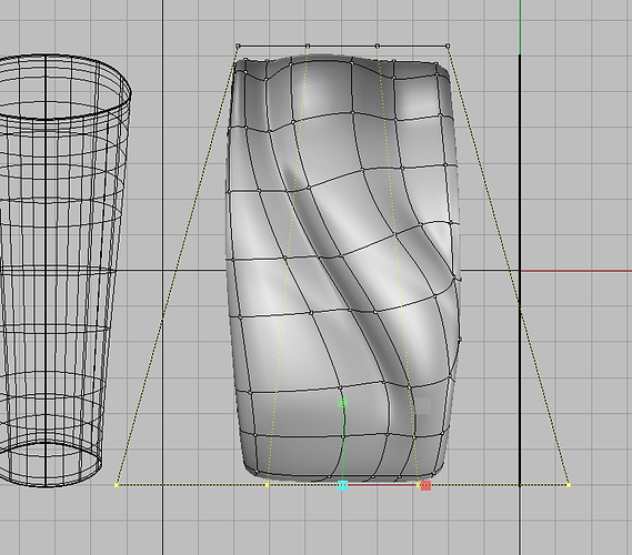

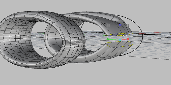

Now turn points back on with your t-splines object for a cage edit in Rhino to taper the bale. We want 2 point rows on the plane of the cage we want to taper. Once the cage is formed turn t-splines back to object selection. The cage will not select the tspline object without points on but you can turn them off once created. This make editing the cage much easier and will give you the result you want.
My photos are a bit weird as I am reversing the making and taking the photos. Once the points are off in t-splines the cage edit works perfectly like it would with a nurbs object.
Turn the cage off and now now you can tweak the top of the bale as a t-splines object or flow it back down to the flat if that is easier. Hopefully you can see the potential here. Have fun.

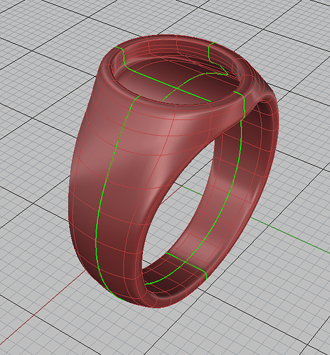

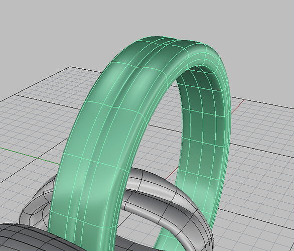

I don`t use the crease command ever. The principle for line definition in t-splines is simple. Larger gaps between lines give smoother transitions and the inverse gives you sharper. You can also tweak this in t-splines with the tsWeight command I believe but I only ever played around with that a little.

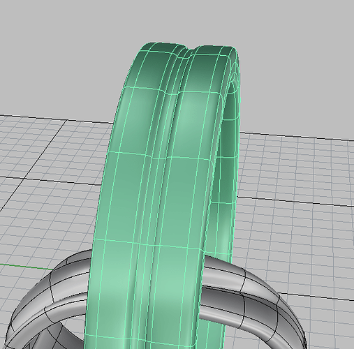

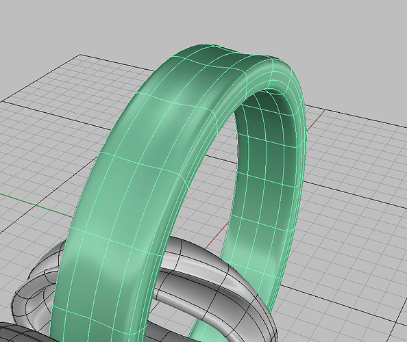

Study the line structure in this simple t-splines band here. It will hopefully give you an idea.
To give it more definition, sharpen up the outside edge you just add more lines out near the edge and position.

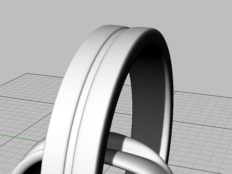

Next the same ring with the addition of a few more loops in the centre and and some scaling… from a crease to what you could turn into a channel for setting.
