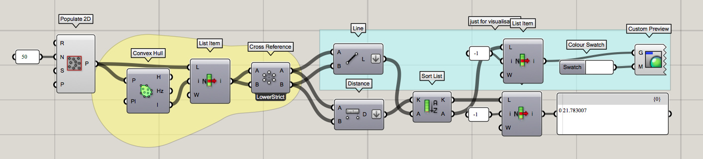

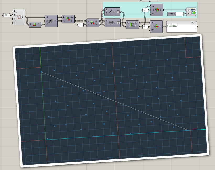

Just for the extra trivia, this is known as the “diameter” of a point set and there are more efficient ways to calculate it than comparing every pair of points ( which takes quadratic time)
Simplest is to filter only the points on the convex hull:

Way more elegant and efficient. Nice solution
