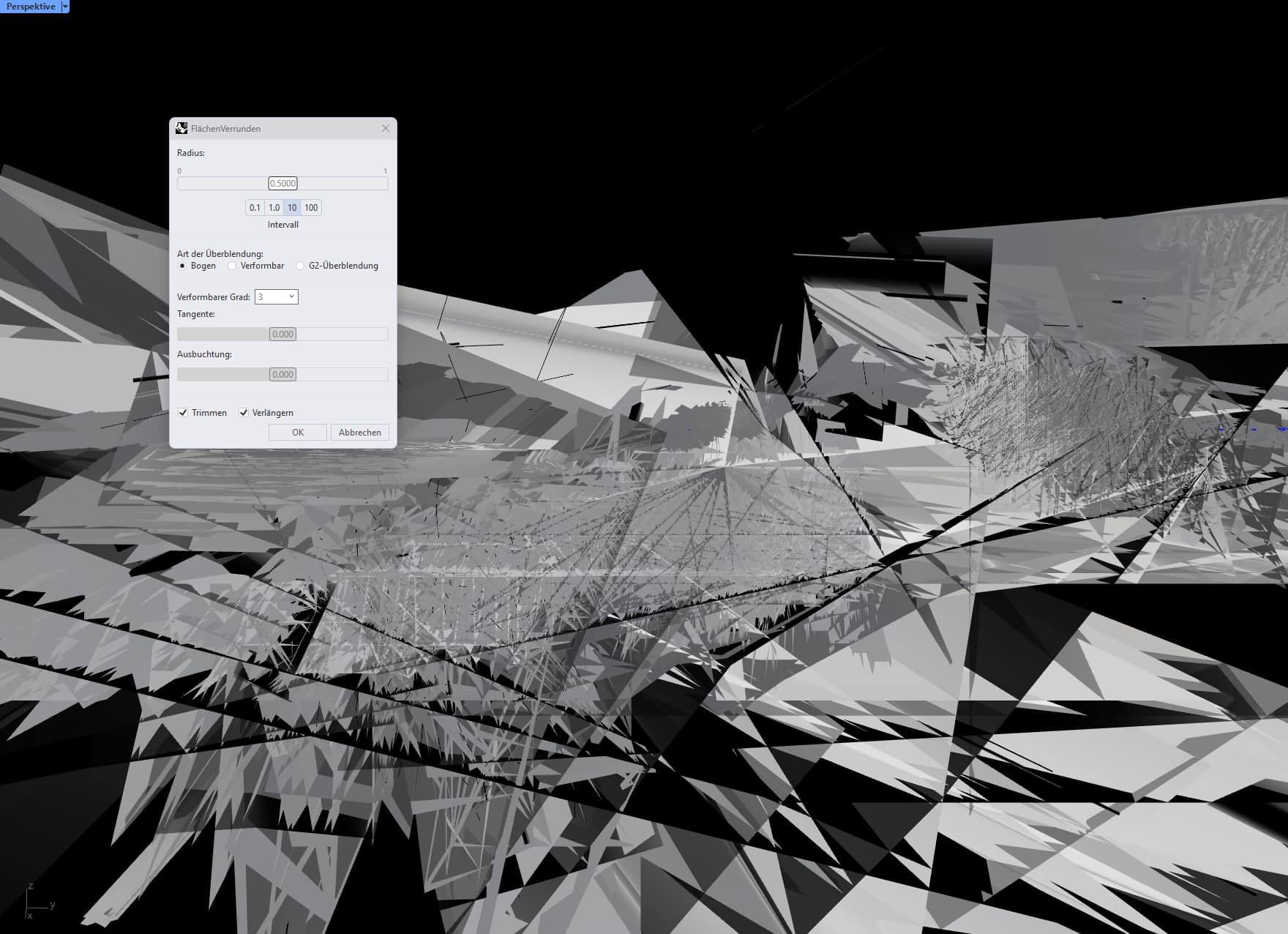

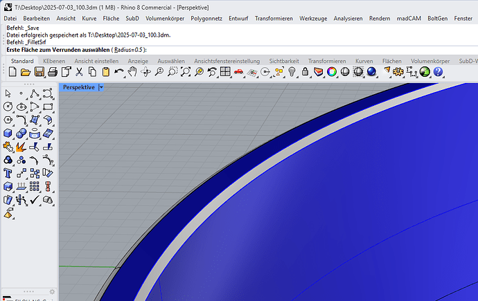

I want to make a radius fillet between the blue srfs.
It takes some minutes to fail, and gives me this:
IMO a fillet of 0.5 should be possible, the distance between the edges is 0.5 vertical and 0.25 horizontal.
Or it should fail quicker.

Thanks for your reporting, I can repeat this issue on my side and I have logged it to our development engineers.
RH-88249 FilletSrf: failed and displayed chaos

This problem - and many others with FilletSrf - has been solved in the WIP version.
