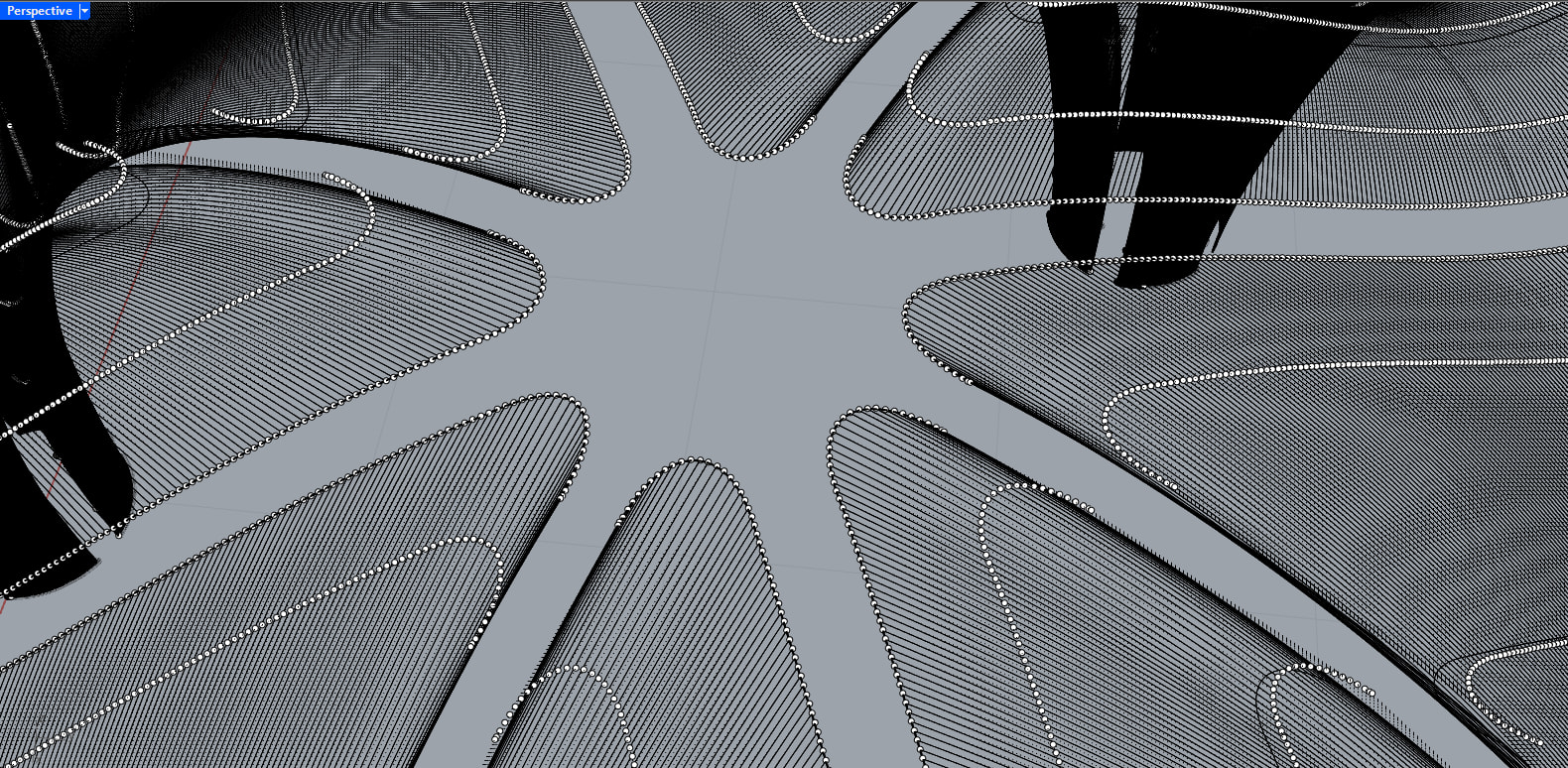

if you bake your original catenary-edged surfaces in Rhino, you’ll see control points flow like this, which is a bad situation for the offset and next eventual mods to be applied to your surfaces:

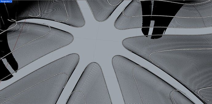

and here is with the suggested change:
