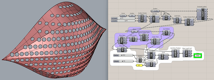

Thanks again, simpler is easier to understand, eh? But details often add complexity. This version adds culling of circles near the edges (see ‘Margin’ slider and purple group).
Normals_2025Jun1a.gh (64.2 KB)
