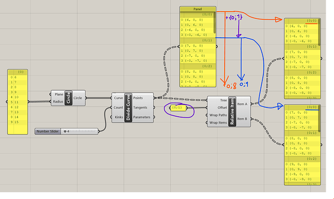

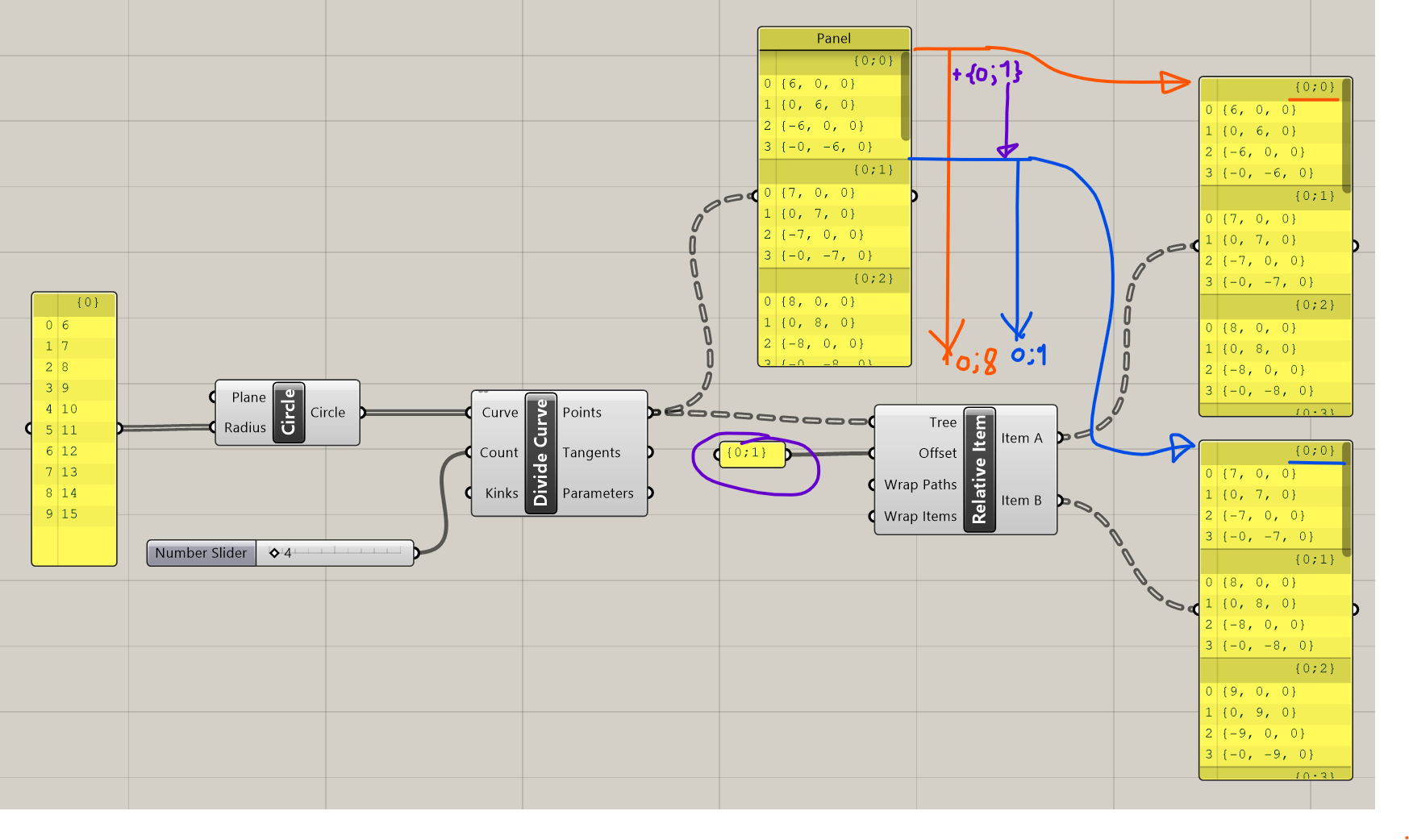

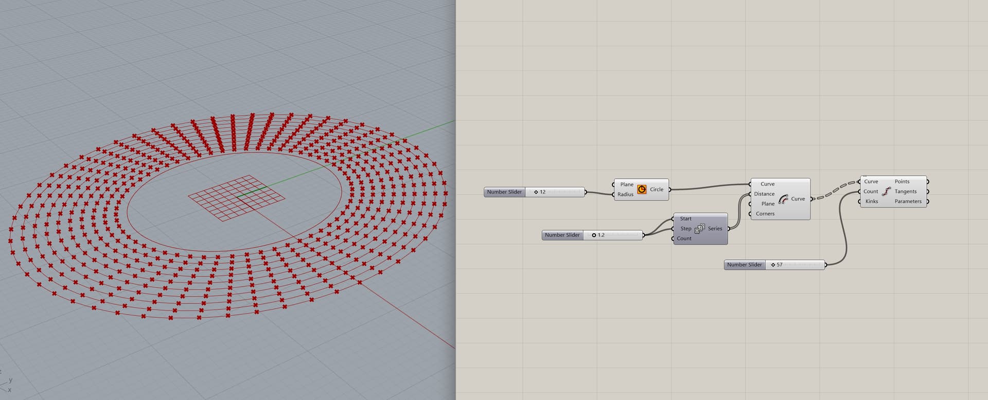

I have this pretty simple task to do but I just found out my skills in data tree management are quite poor. For each of the point generated in the circles I need to extract the number of the circle. I understad the componets to be used are deconstruct tree and list item but I couldn’t figure out how to do that.
The circles should have path numbers {0} to {9}
The points are in paths {0;0} to {9;56}. The first number represents the circles.
Here’s some more information:

What do you need the circle number for? Without knowing what the next step in the process is, it’s hard to advise.
this is just a mockup of a part the real script I m doing, exactly where I’m stuck. So to be sinthethc the circle likely correspond to a number of planar splines with different Z whose point I need to compare with the analog ones on the lower spline. To be precise I need to compare the Z to get the relative height of each spline compared to the previous one.
